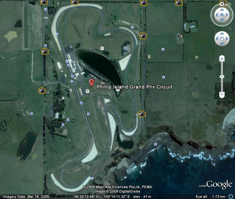

It's a bit of a long boat ride but well worth the effort...
- Phillip Island Grand Prix Race Track.jpg (76.28 KiB) Viewed 10564 times
Re: What to look for when purchasing a Race GTV6
What exactly happens there if it's well worth a boatride from Sweden? Gotta be something very special indeed...MD wrote:It's a bit of a long boat ride but well worth the effort...
