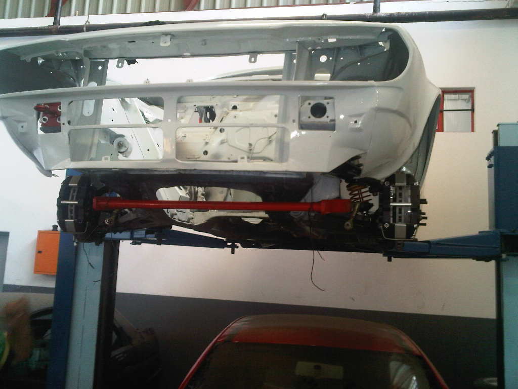

Firstly this is not my car but I did do engine conversion for owner Nelson. PowerMods are fitting gearbox upfront and all suspension,brakes supplied by me.
PowerMods are famous for "his" 155 twin turbo rear mount and new 155tt front mount being built.
The GTV is just gonna be a fun club racer with 15'' rims and later two big turbos bolted on.

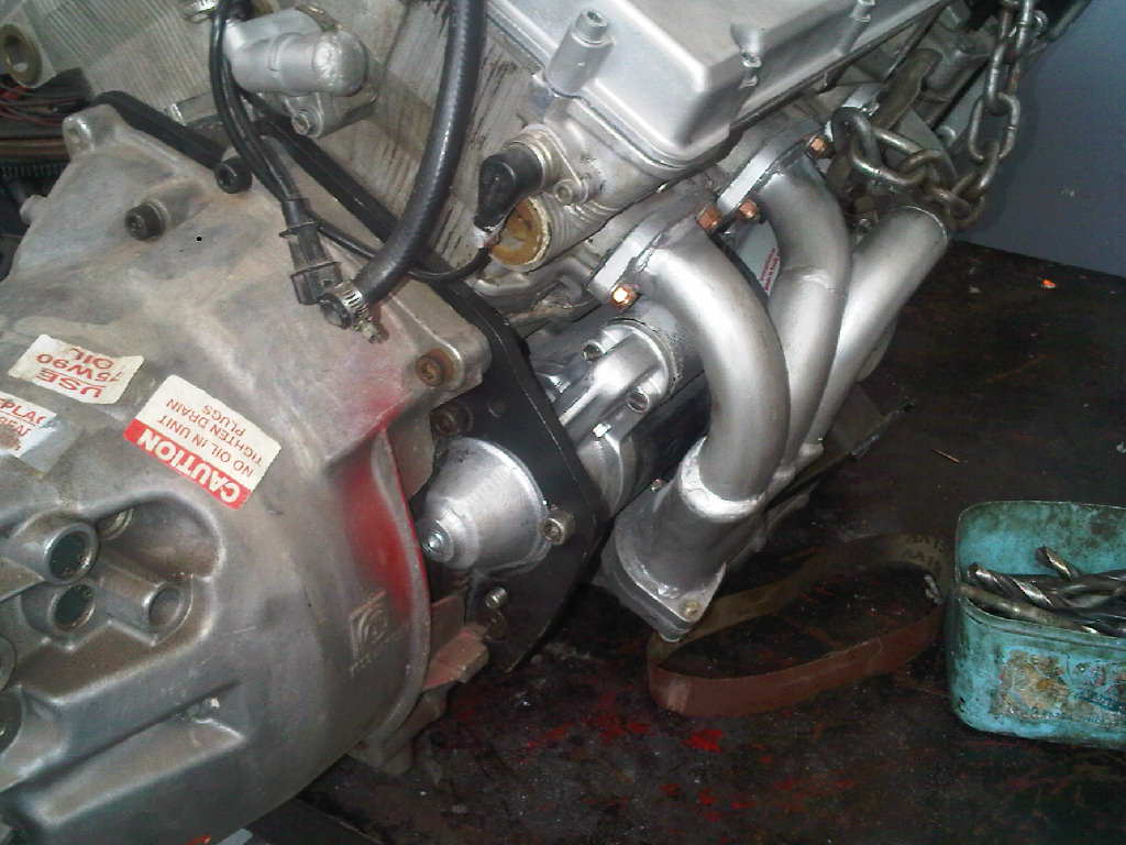

Dont pay attention to stickers on gearbox.
Re: Original GTV 3.0l race car build gearbox upfront (Nelso
Hey Jim , your headers I sent should fit and look like the ones above.

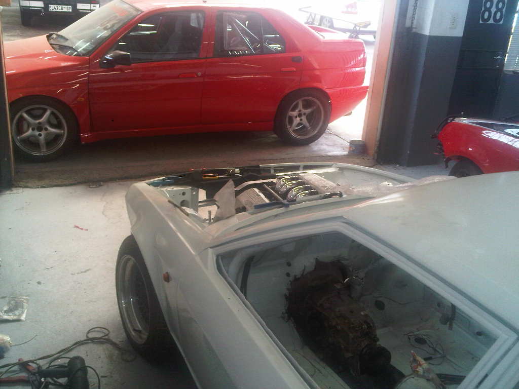

Pic of engine in but will come out again to neaten up firewall cutting

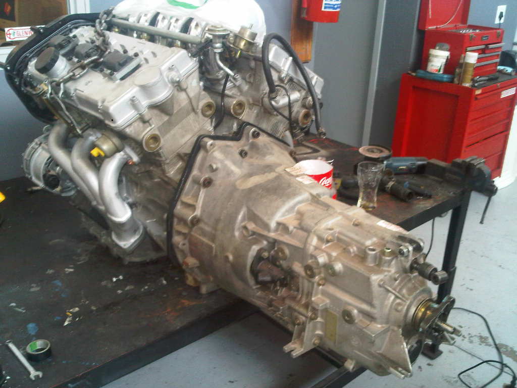

any pictures of the complete trans tunnel?

Kevin I'm either blind or illiterate, but what kind of gearbox is that (car/manufacturer)?
Its a 5sp getrag from an M3 . I got some more pics of tunnel. Its coming on nicelly as they took a tunnel out an m3 then shaped it to fit the gtv.
Surely you mean a ZF from an M3? E36?
Domingos told me it's an E36 5 speed M3 box. And that's a Zf unit. :wink:
Yeah late stuff , its from E 36 zf . Not sure why i wrote getrag and 5 speed. ( to busy watching SA kicky Ozzie ass in cricket :D , not that i like cricket :D )
