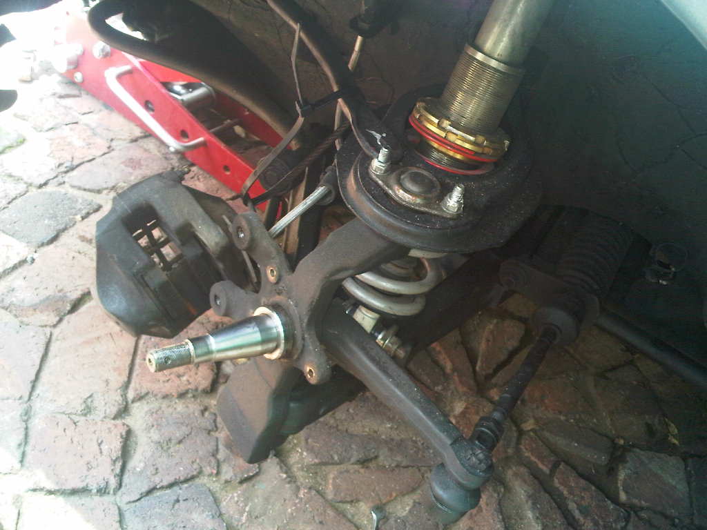

RS suspension has been fitted , braided hoses , ferodo discs and race pads.

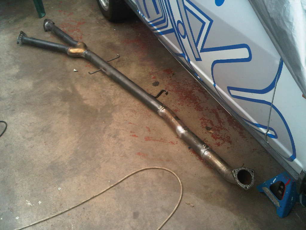

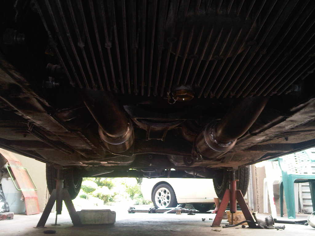

Exhaust has beenn a bit testing at the moment but will discuss later.

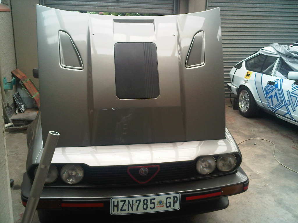

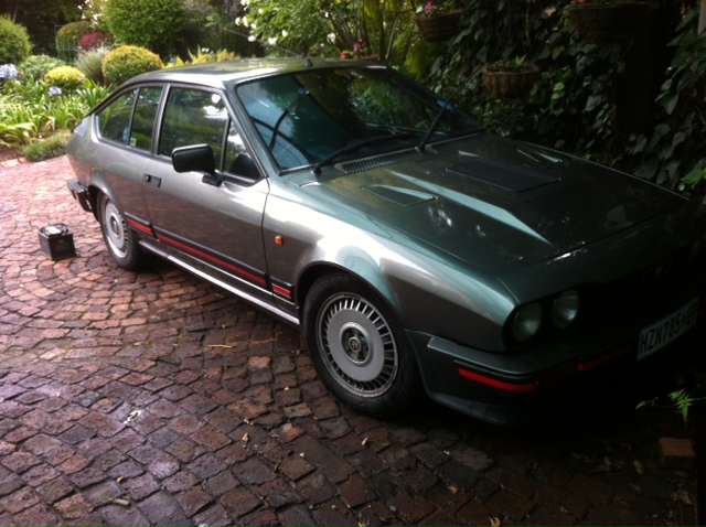

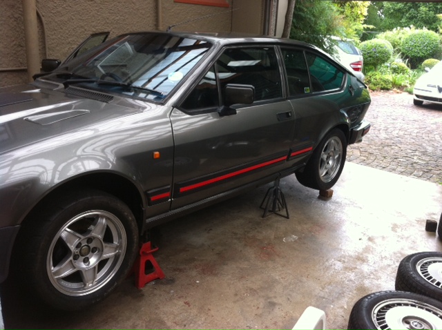

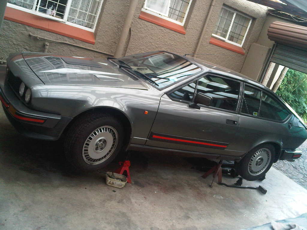

Pics of the car itself. This bonnet or hood comes off my old TT GTV hence the air ducts. This car was a genuine GTV 3.0L but the engine was changed by previuos owner to 2.5 and injection fitted so we had to remove the fiberglass "bulge' bonnet. Also the reason why there are the original red striping on the trim . The bodywork has just been touched up and trim will be completely fitted later .
Owner will join forum to continue this build soon .

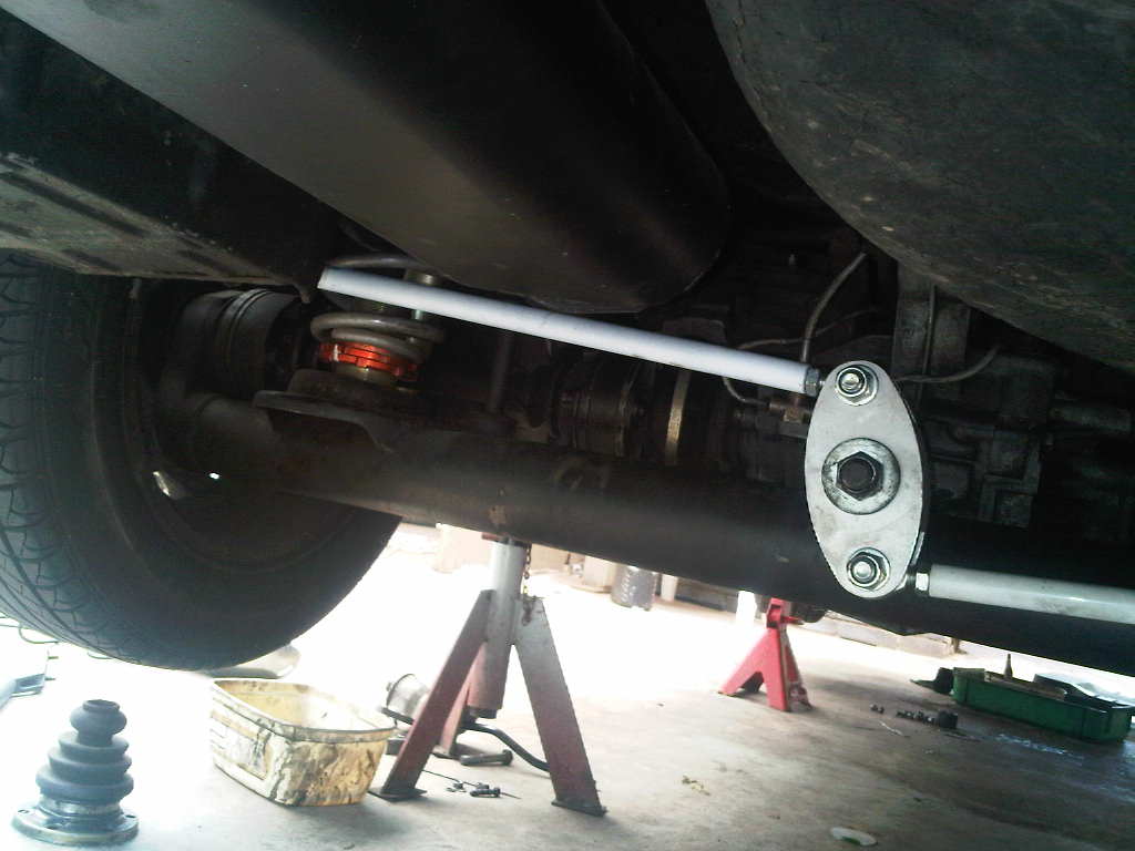

5) Adjust exhuast as it now touches on new WATTS link (RS)

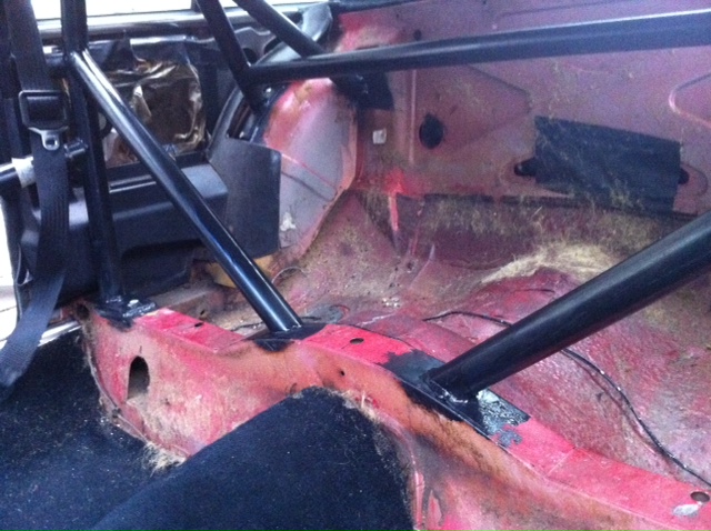

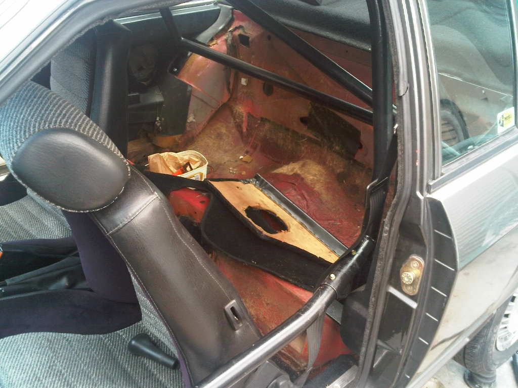

roll cage welded in
roll cage welded in

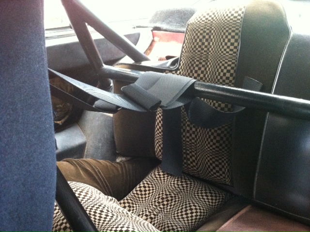

This roll cage was a bolt in cage with the rear section now been welded in and extra bracing added. As mentioned it's a compromise class so you cannot weld the entire cage in . The cage has been tied at b pillar to just above seet belt and then directly off that point at 45 degree angle to the tunnel. At least the rear section of the cage is tied into body.

6) Exhaust all sorted

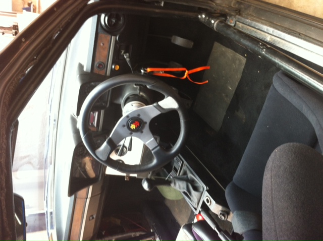

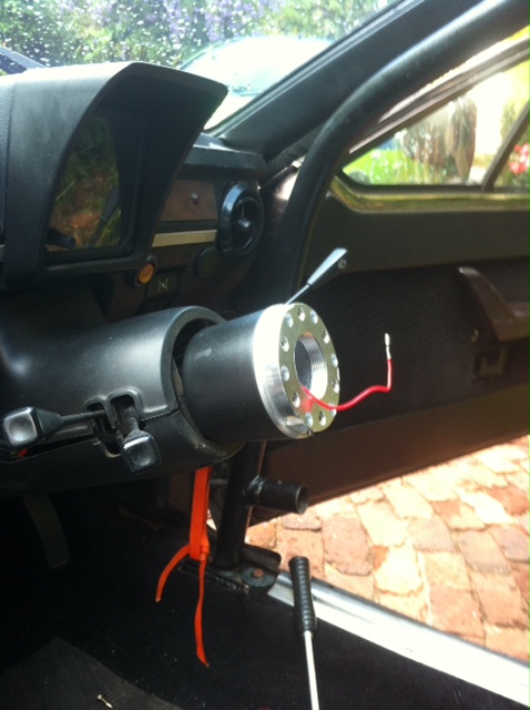

steering Boss
steering Boss

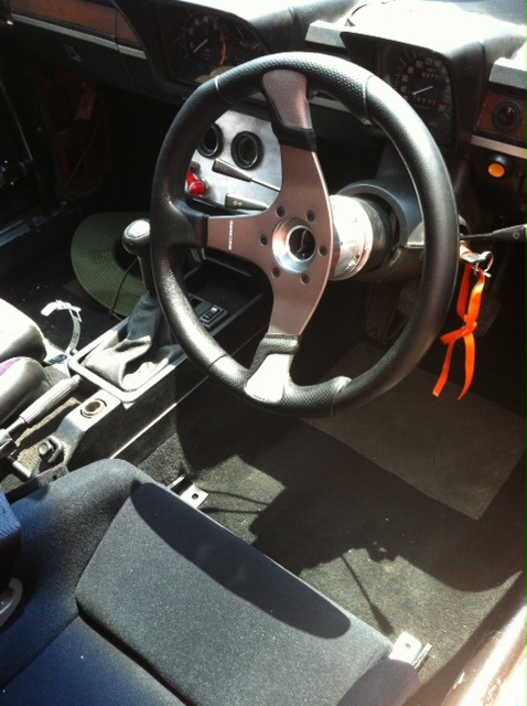

The steering wheel - Momo 350mm

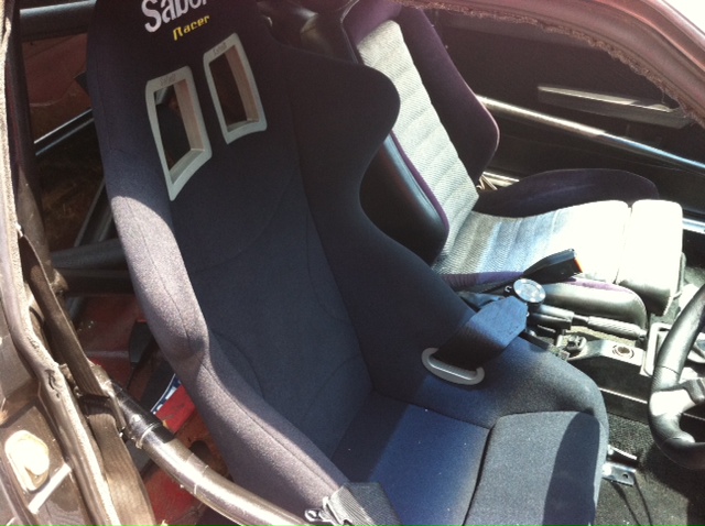

The seat itself = sabelt

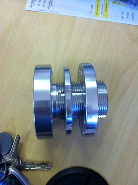

Steering wheel adjustable spacer - 20-80mm

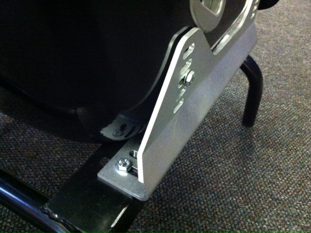

Seat anchors
Seat anchors

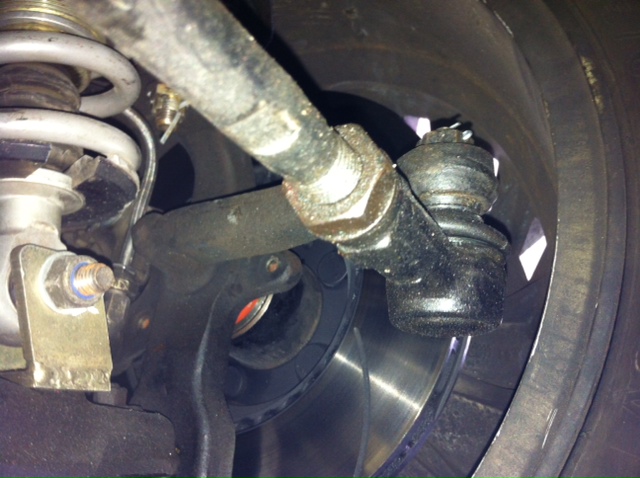

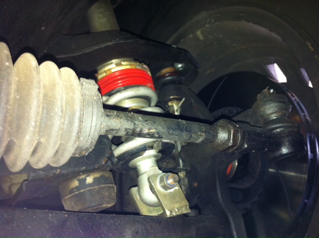

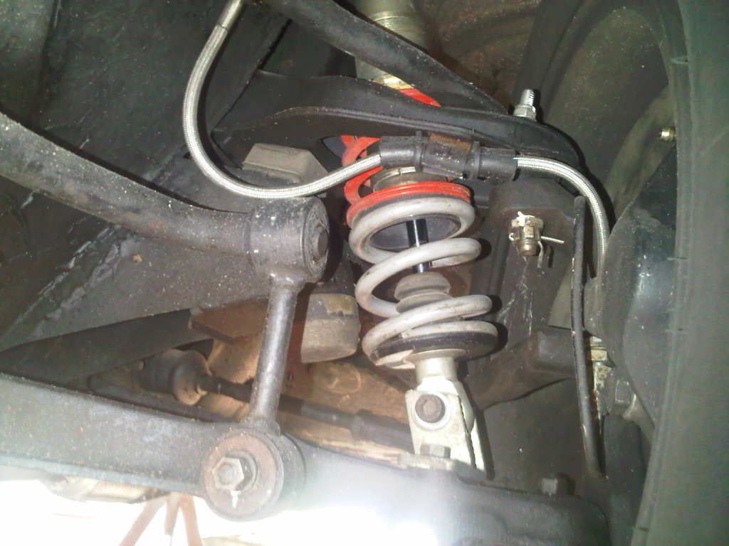

Front suspension details
front brakes again
front brakes again

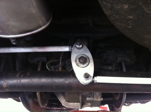

Rear Watts Link - rose bushes

It's finally getting there , not been easy though . Always picking niggles with fitting items while trying to keep full interior . Items like fitting hooter, seat, fire ext, bonnet clips have taken longer than fitting whole supension . :roll: You see us really bending the rules by cutting the rear seats to fit around the existing bolt in roll cage which was modified with a couple of extra cross braces welded in in.
Roll cage is not pretty but B and C pillars are picking up the load points nicely and are welded to the body.

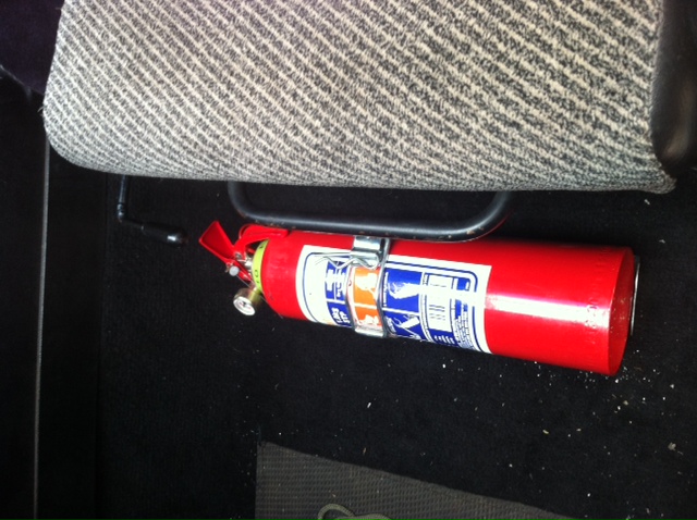

Fire-extinguisher fitted...

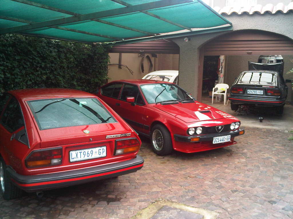

When I grow up I want to be!!!!! - no points for guessing to whom these wonderful specimens belong!!!!!!!

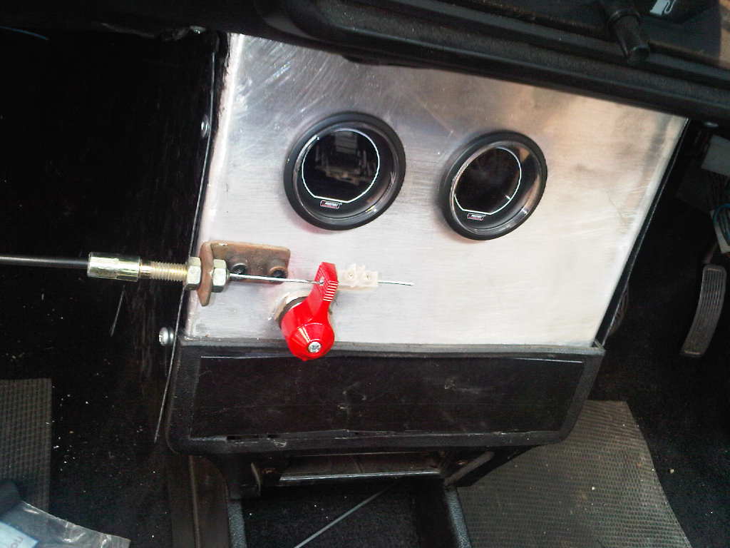

Cable from "In-car" kill switch to external knob + dials (Oil Pressure and Water Temp)
