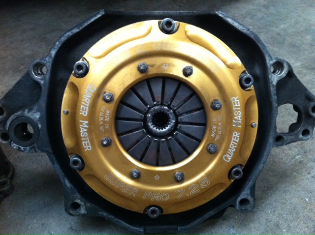

As a side note, if you do go down the path of using a quartermaster or similar clutch, be aware that it may be near impossible to find clutch plates with the correct spline. my solution was to use the centre splines from some old 116 clutch plates, turned down and fitted/welded into the centre of a pair of quartermaster clutch centres. once done these centres can be re riveted onto new plates as needed - any good clutch specialist should be able to do this work for you!
this is the clutch and flywheel assembly installed in the clutch housing. once this is done the release bearing install height can be worked out and the adapter made.

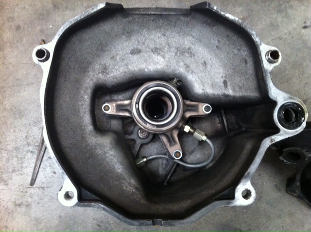

the best i found, again this being a cheap Ebay score, was a Tilton 1500 series release bearing part # 61-1512.
the great thing with the release bearing is that, unlike some others, its self adjusting, so the initial setup is made that much easier as install heights don't have to be spot on!
if you are still going to use a std clutch, it would be worth checking to see if these aftermarket race-spec parts effectively operate on the std setup. alternatively quartermaster make some quite nice units that may be much better for this purpose.
there wasn't enough space to mount it with the bleed hole at the very top but i was able to fit it in by canting it to one side and removing one of the mounting legs.

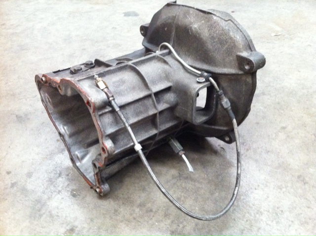

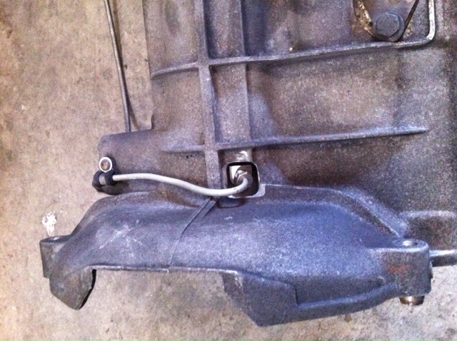

this shows the installed bearing complete with feed line from the exterior of the box. the bleed line runs out the top as shown on the pic below.
the bleed line then is run via braided hose to an easy to reach place with a bleed nipple on the end.

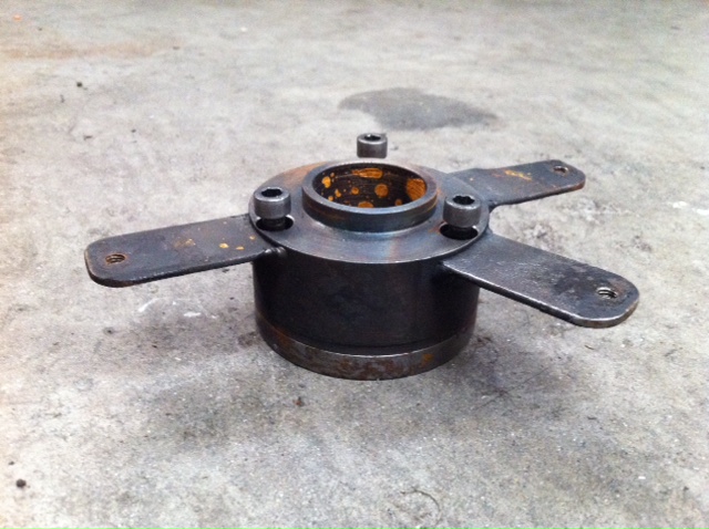

for mounting, i turned up a piece of steel that bolts to where the original release bearing tube attaches. i drilled out the 3 mounting holes and recessed them so the release bearing could sit flush. the front edge of the mounting bracket needs to have a spigot on the end the same diameter of the back of the release bearing so as to accurately locate it in the centre of the clutch. i then welded on 3 small legs, which were then drilled and tapped so the bearing could be fixed to the mounting flange.
depending on the flywheel and clutch used the thickness of the mounting flange could vary quite a lot. mine is approx 40-50mm long.

here is the adapter, its nothing flash. its made of steel so it was easy to weld, but im thinking of going to ali as its much lighter. the steel version is quite heavy.

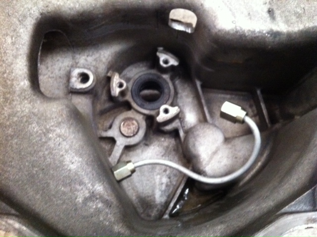

also the front of the gearbox with the release bearing shaft removed.
