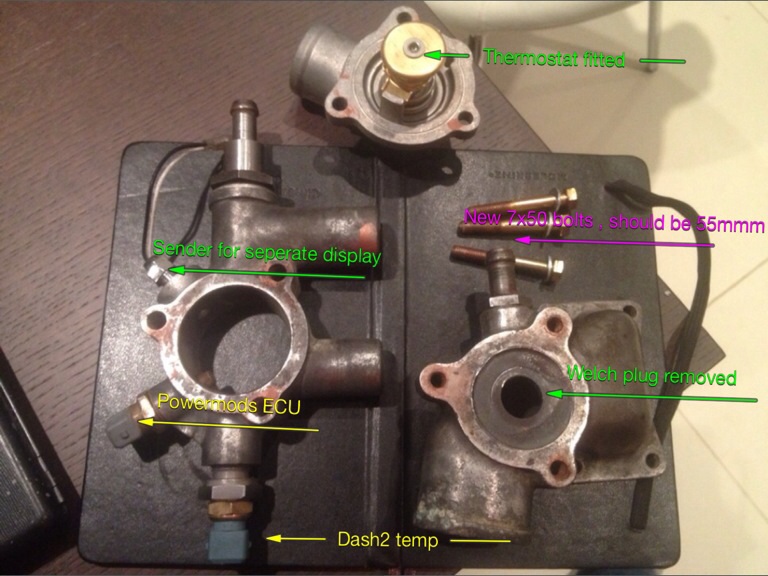

Anyway some bits and pieces completed . I removed my old thermostat housing which was plugged with a welch plug ( mentioned before) . I now have two outlets for my heater hose in front . This is identical to set up Alfa used on the carbi GTV 3.0 as the don't take water off the back of the carb heads .
Trying to find new 7mm x 55 bolts is impossible and could only find 50mm long and nothing longer to trim down . Important to apply some copper grease to bolts as these always corrode .

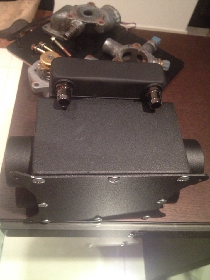

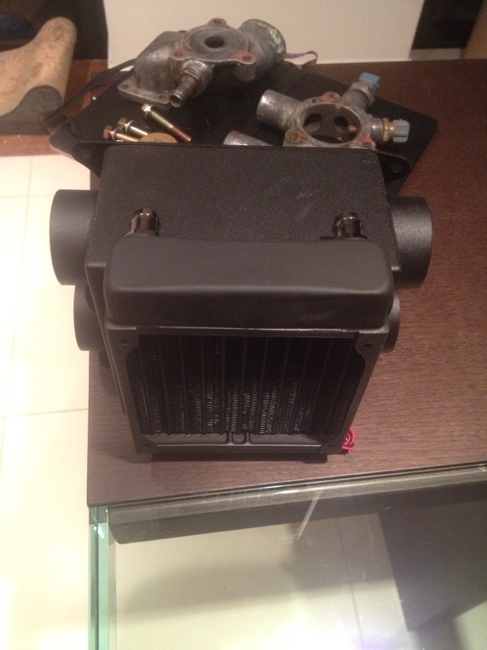

The heater unit is very light and draws a very low amperage . It came well recomended by the rally motorsport guys .
Now must get the ducting right to get most effective way of keeping windscreen clear . Some pics to follow

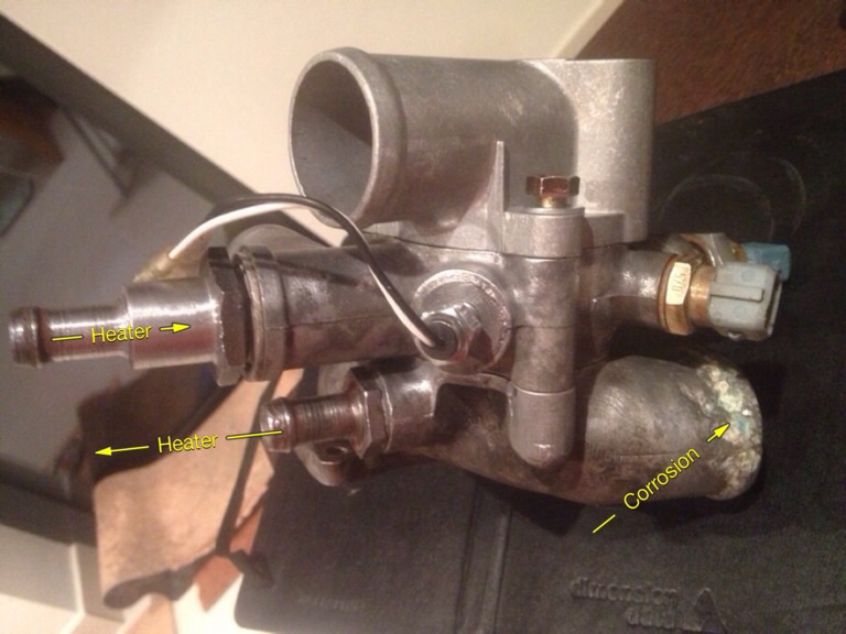

In the pic above you can see the corrosion on inlet water pipe caused from trapped water under the rubber and before hose clamp . Not sure best method to build it but was thinking of using liquid steel . Then smoothing it when dry and finally apply some grease around it before fitting hose to slow flown further corrosion . Just hope none of the liquid metal comes off ( seperates ) unless I make sure hose clamp is directly over that area and it will prevent water been trapped . On the bright side that's 25 years of corrosion .
Kevin,
I am surprised you are still using 7mm bolts in the thermostat and associated alloy parts! Most of the time the alloy threads are stripped in older cars, so (even if they are not corroded) as standard practice, I replace them with M8x1.25 bolts after suitably drilling/tapping the parts concerned. Bolts come in 5mm length increments so no cutting required. Makes for a better, sturdier assembly and never had a failure yet. It helps to also sand the surfaced lightly as a precaution, as I have found several distorted parts through the years. Note I don't use any of the 3 gaskets either -makes for a lighter engine :lol:
Jim. , yes that is correct way to do it but unfortunately I don't have tap set at the moment and the threads are still perfect . But now that you mention it I will borrow a tap set and use the correct length bolt .

Maurizio

All the M7 threads I pass, I replace with M6 by adding thread inserts.
I gave up on finding M7 bolts in the correct size :D
To get an idea..
At work we use for all connections in alloy which are opened repeatedly, always these inserts.
Cast alloy is anyway a pain wrt threads....
Pipe corrosion is a bummer but you should be able to prevent it by installing suitable magnesium anode plugs in the block. I do remember seeing such items somewhere for 4 and 6cyl engines a few years back, but you can make your own custom jobs on a lathe from home water heater anodes -I've seen them to be ~1" thick and ~10" long (c'mon MD, no smartass ideas here... :twisted: ).
Already corroded parts can be simply repaired with alloy welding, no problem.
Those inserts are a nice idea Maurizio, for something you open up frequently. How many times will you have to disassemble the thermostat? I think M8x1.25 is a more practical solution in this case. We use these inserts when necessary to replace corroded/broken/stripped long M12 block/head studs on otherwise good 4cyl blocks. We get them from Wurth and they are called 'time-sert'.
Thanks Maurizio for alternate options . I'm not going to use gaskets either so I'm going to save 2mm so I'm happier with the 50mm bolts . If the bolts don't bite with the reduced thread then I got the options of the m8 by 1.25 or the inserts .
I'm pretty happy with the 50mm x7mm bolts that went into new thermostat housing . Al his tightened up nicely . Hopefully now the engine will warm up quicker to stop over fuelling .

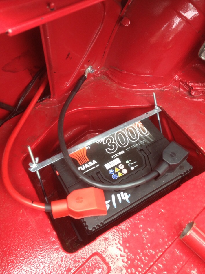

Got some good battery terminal covers to comply with racing regs here and also I don't have a battery cover so it will be much safer incase something loose in boot shorts against positive . (Still got to load things in boot to go track days ) .

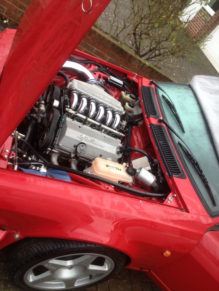

Can't believe how much moisture is in the air . The car is sopping wet even with this breathable cover . Hopefully no corrosion will happen as I have Dinitroled all cavities and the whole is body colour . Must just stay away from when they salt the roads .
Pic shows how much moisture gets under the cover ( see all the water droplets on the bonnet on both sides :shock:)
The 'clamping bar' that goes over the battery can also cause some nice sparks if it gets loose.. :wink:
Good point , I should turn battery around and then heat shrink the clamping bar as an extra precaution .
Thanks .
Edit - done with new covers
