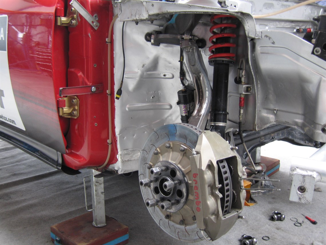

Reviving this thread.
Does anybody know if the supertouring/s2000 suspension components are available to buy anywhere?
I struggle to lower my track 156 GTA car without compromising the roll centre so i am looking into options to adjust the geometry of the double wishbone.
Also adding a photo of a S2000 car to contribute to the thread :)
