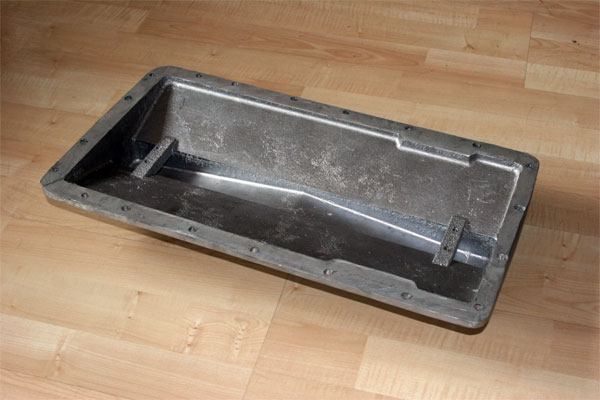

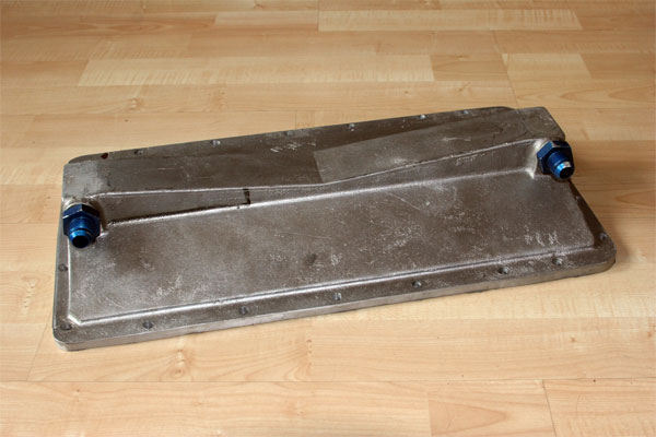

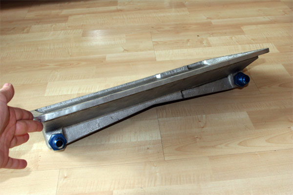

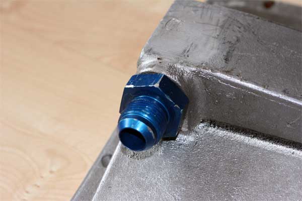

My setup is the same a Julian's, with cast sump from single seater modified to fit Alfa V6. The sump pan needs a small bit chopped out of the rear to clear the crossmember, but Glenwood would usually do this for you.

Dry Sump Pan
I may have missed it but can anyone tell me where I can get just the drysump pan shown in the pictures? This is perfect for my application.
