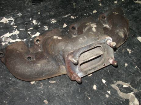

this the Evo/series 2 exhaust manifold isn´t?
I think that my future car have one, if doesn´t i know were is this one.
Yep, Evo manifold. I have it on my car, doesn't really need to modify anything to fit it.
You may need to apply "gentle pressure" to make the turbine clear the body when you fit it over the studs though. ;)
I made a 3" free flow exhaust at the same time so I can't really say which mod made any difference.
