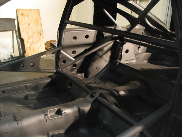

I felt that a solid chassis is the foundation for a good handling car. I spent a lot of time in designing and developing the roll cage. The car is STIFF... much better than my M3 cage. I feel like all I need is some decent suspension components to make it fun. The balance is good. The body roll... not good.

Does your cage extend to the shock-mountings? You need that if you add full coil overs, but I don't think I need to tell you that.

But is the cage extended to reinforce the front shock towers? This is the most critical as the front flexes a lot under hard cornering. Go really stiff on the front as this will reduce roll.

BTW. How did you fabricate the holes in those gussets? That looks really professional.........
