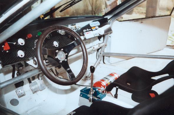

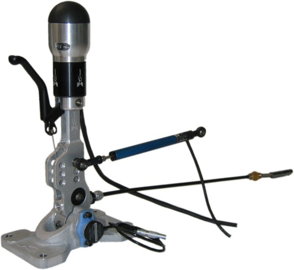

For those of you who are interested in an alternative to my selector could consider this commercial proposition from Xtrac in the UK. The following photos are of an installation in a front wheel drive vehicle so you have to imagine the linkages going the opposite way. What is at issue here is the exellent changing mechanism that can be set up just to suit you personal requirements.

These pics are from a local front wheel drive race car. You have to imagine it working in reverse order but the application principles are the same.

hmmm looks very good but our alfas are transaxle ... with this shifter you will turn gearshifting opposite ... first will bi left and back and so on .... fixing point of this shiftier is on bottom ..on transaxle alfa we need fixing point on middle of the shifter ...

That's actually very easy to work around.
But I still don't see how it is better then the original (old) linkage where we have one (1) joint in total in the whole linkage.

Glad to see somebody is actually thinking about this item because it is a great racing shift solution. Yes, you are correct that you will have a mirror opposite shift pattern but as Mats says, that is easily rectified. I actually had this pattern in my car for about six months as an anti theft device !
You just have to believe me that the original design is sound but the problem with it is the length of the lever points. This is what causes the long throws and wide gate. Otherwise you too are absolutely correct. The fewer the moving parts , the greater the reliabilty- and engineering fact. However, when you get this sucker right, you are talking about a difference of 99.5% vs 99.8% fantastic (as a concept) so it is very worth while pursuing.
Put simply, the set up that I use and illustrated on the old site has as sharp a feel as a 105 stick- in- the- box but with a shorter throw like an Ford Escort for example. Gone is the slop, the long throws and wide gate and the general vagueness of where the gear actually is.
There are no royalties in this for me so I am not pursuing it for any other reason than to genuinely give Alfa racers an opportunity to think through an alternative because you don't have to put up with what is there. There are better ways and this type changer can get people thinking to find that alterantive.
