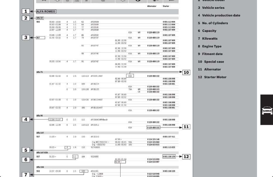

Hi can anyone tell me the BOSCH part number for the smaller lighter starter motor that came on the late model 3.0 75 . Its from 89 to 92 .
I have the part number from the earlier starter which is same part number as on the gtv6 which is 0 001 108 098
Anyone ?
EDIT : the above part number is for later starter . The bosch charts have given wrong info see page 3 .

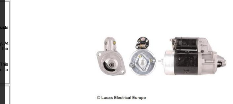

I found a Lucas replacement on this site . I'm wondering if it was only Lucas that supplied these for the late model . See this site
http://www.kimbercarparts.co.uk/electri ... Parts.aspx

This is the larger starter next to the smaller type .
But according to he bosch site they all had the same part number which is strange

Apparently if look for LMS329 starter you will find starter motors for the Alfa v6 and it looks small. Search results indicate its popular in the Uk.

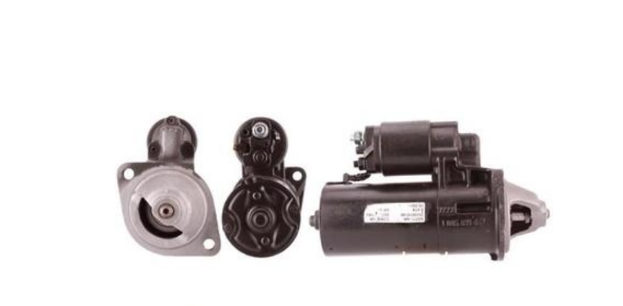

The old huge one is direct drive, the small new one has reducer gear drive. Here they are:
Re: Late model 3.0 75 starter Bosch part no ?
Does that smaller one bolt right up? If so that's a good upgrade!
