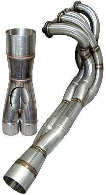

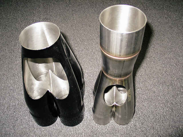

That sounds pretty good. If you are going to that much trouble you may as well include a goilet termination of the primaries into the collector. This will maximise the smooth flow of the gases within the collector. Now I know every kid on the block will want to know wtfk this is.
Well, the best I can do at short notice is a shitty pencil drawing which I hope gets the message across.
You could flange fit the collector or wrap it around the primaries depending on space available. For ease of servicing, I would go the flange route.
I must be dyslexic nor can I spell in french. The word is goilet not goiter. Had you all off the scent for a while ha ha..
Note the one on the right is a venturi collector type which causes gases to speed up at this point an supposedly create a vacuum behind it.

MR Turbo. You are on the money ! Exactly. Now I guess the theory is that the actual collector volume needs to represent the volumes as I have previuosly said to allow the gases to expand at that point and create a vacuum in the primaries behind it. This causes "slugs" of gases from each cylinder to move in rapid succession corresponding to the RPM much like machine gun fire. In doing so , it will create a negative pressure behind it helping to move these exhaust gases out.
It is why the correct name for headers, primaries is the term extractors. It is also why it is so important to match the length and inside diameter of each primary pipe to the nature of the use the engine will be put to eg. towing work, 4 wheel drive work,general street use, rally, or tarmac racing.
So you can see that when somebody says, oh yeah, I think I am going to fit a set of headers the response is -here we go again. All is well but one has gotta do the homework and build the entire sytem to achieve what it is the modifications are needed for.
Good ferreting by the way getting that pic.
