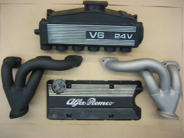

Here is a picture of the header that I have for my Alfa. We went with the silver one and as you can see they were custom built. We had alot of problems with the starter when we were originally sorting the Alfa. I think we are using a stock 164 starter with a special heat shield that was made by Phil. We are using stock motor mounts that have about 533 miles on them so far. Thanks for your help.
- Header Picture.jpg (44.46 KiB) Viewed 12074 times

Yep, i know where those come from. The leak will be where down pipe joins header. Its the only place these types have ever leaked . just get long pipe and put it by your ear and other by that flage connection. you will hear straight away . If not put pipe in rear of exhaust and into car and lock yourself insde.

I cant be 100 % sure but they look identical to some sets that were made here in SA by Mocanbiquen chap. He made some for me as well which I have on my other cars. They work great with the correct gaskets. Sadly this chap was killed (not by an angry customer iether - just general crime). The last sets which dont cross over come from two prominent shops here. I dont make them but other engine tuners here borrow my jigs which I made for my own car. Whether they use them correctly that I dont know as the flanges must be firmly bolted during entire welding. I had ten sets made which went to my cirle of friends that race here with absolutely no issues. So they should not be any issues if they are checked. Guys who borrow my jigs might not and just send them out with out checking faces etc.
