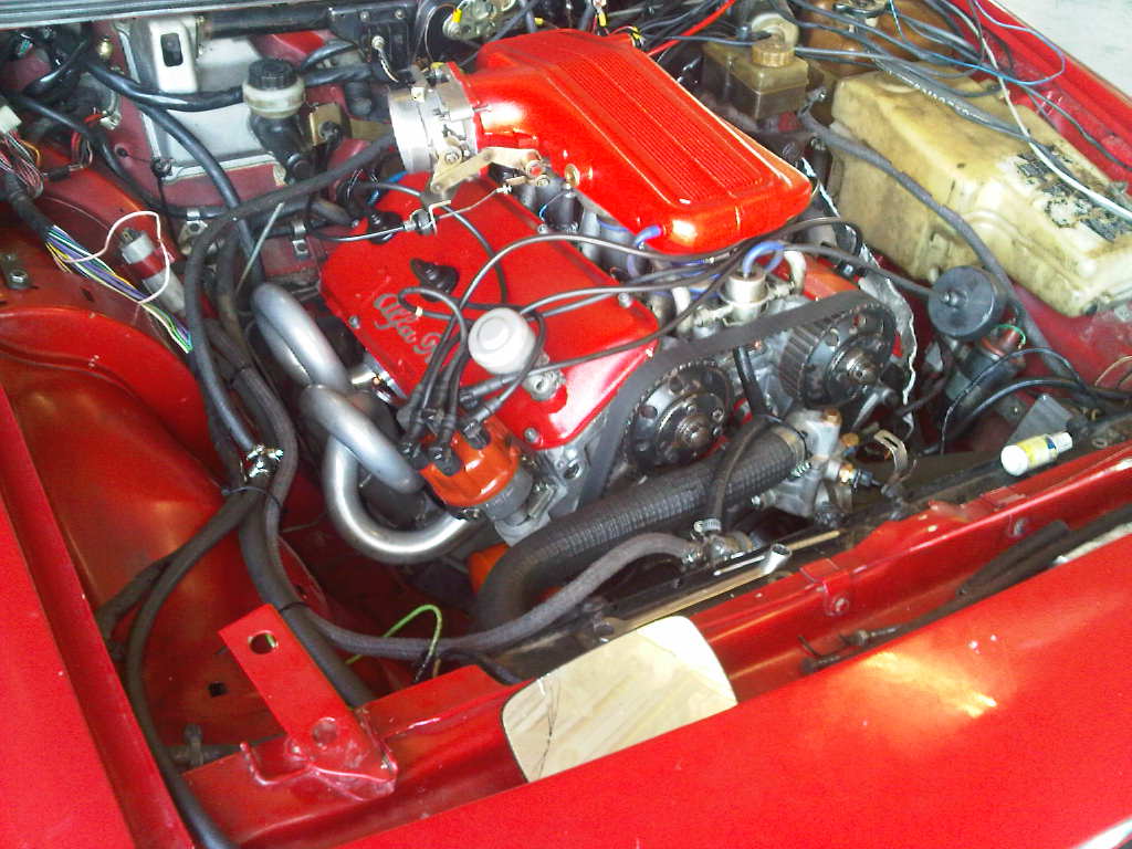

Some pics of a 3.0 12v race motor in test bed car at glenwood. What music this makes and it looks the part. Thought exhaust would interest .

I guess this is the right topic to speak about exhaust manifold :lol:
These are my DEVIL SODEMO (road version)
After this "try" to check everything fits ok, they were glassblast and alumiun
These are SODEMO for race using during eighties by Snobeck Racing team (SRS)
