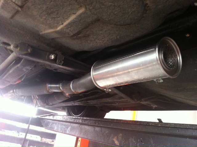

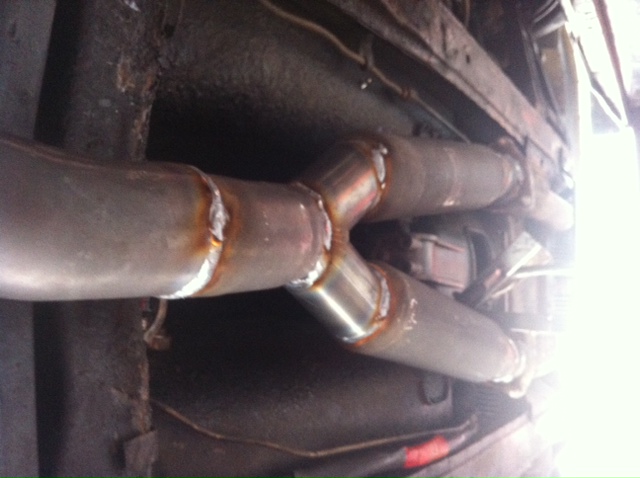

Hi
Pictures of exhaust setup - Will post the FINAL side view soon as well
side exhaust 3.JPG (102.01 KiB) Viewed 12930 times
side exhaust 2.JPG (105.78 KiB) Viewed 12930 times
side exhaust 1.JPG (95.63 KiB) Viewed 12930 times
