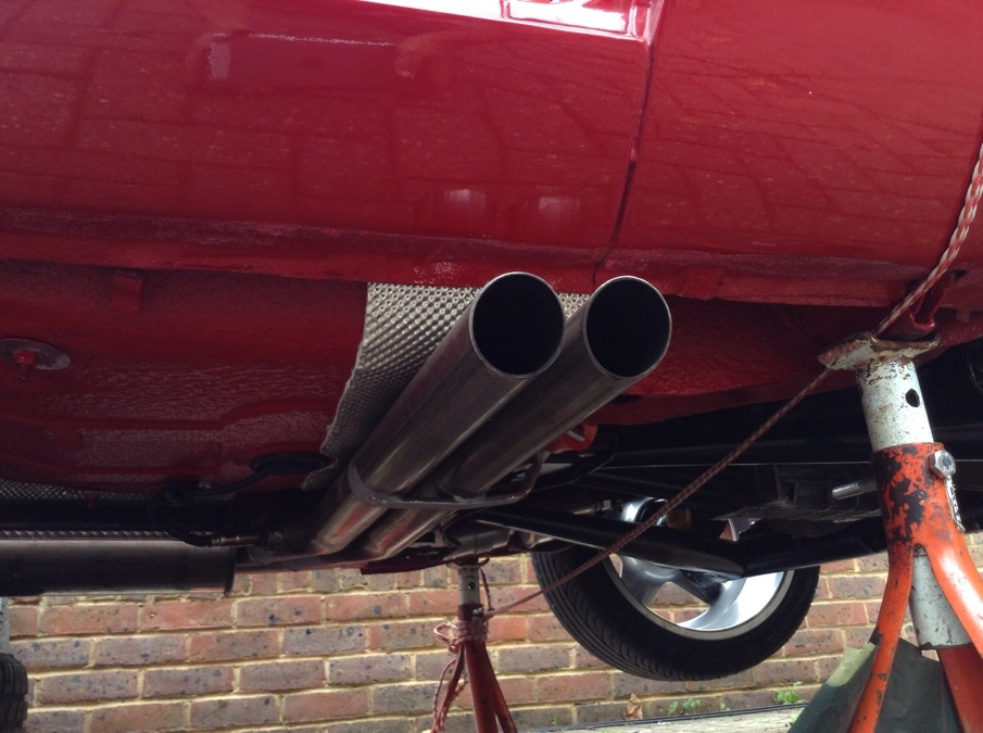

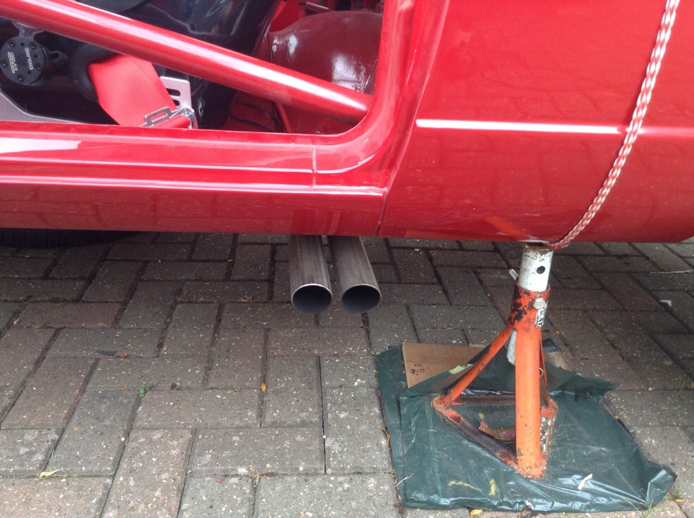

I'm trying to find the right product ie after market end piece that I can interchange on my side exit exhausts . It will need to be about 400 mm long max and 70 mm diameter as that all the room I have if I cut and make joint near the end of the side exits . I can always put sleeve pipes on and clamps then attach new end piece to body just like I have now .
. Trackday DB is my problem not MOT and also I think my neighbours ( or even neighbourhood) are about to raise the issue .
I really don't want to suffocate the engine just merely trim it by plus minus 5db to get it around 97 . My side exits are 50mm . Has any one had to add anything to their cars just to take th edge off ?
- image.jpg (166.45 KiB) Viewed 13695 times
- image.jpg (248.23 KiB) Viewed 13695 times

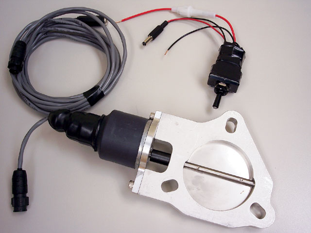

Probably the best thing is to get twin adjustable electronic valves. Keep it 3/4 closed in town and for MOT tests and wide open for the track. Also if you add the V-band clamps after the electronic valves, you can replace it with very restrictive 1.5" resonated pipes. But I think the valves alone should help keep the noise levels down.

I don't have room above box for the electronic actuator as there normally very high . Maybe I have not seen the tight product here . Ironically track day db is the problem as its not to bad up to 4000rpm . It already had two small boxes on . I guess its the 100mm pistons that create that deep noise down the pipes .

You can mount the actuators in any orientation, so the gap between the pie and the body is not a problem. I just noticed that you said you have no room above the box, I'm assuming you meant the center muffler. I don't think you mount it there. You can mount this type of valve (attached pics) after the muffler
But it looks like the gap between the 2 pipes is small and that could pose a problem as the valve body itself is a bit bulky. You could try a mechanical valve as the valve body is slimmer.
This one functions on vacuum.
http://www.amazon.com/Weldable-Stainles ... B00HPC1P00
Install this on one of the pipes. When it shuts off, that pipe acts like a helmholtz resonator and should take out the low frequency. And for the other pipe just restrict it down by 0.5". Or install a turndown with a cone like ones from dynatech.

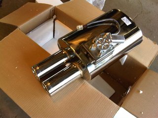

http://pitstopusa.com/i-5069645-dynatec ... e-3-5.html
Or if that doesn't work out for you, this varex muffler could work out for you if you replace your current muffler. Get the 2 in 2 out version (a bit expensive), but the mounting of the actuator doesn't seem to take too much room under the body.
