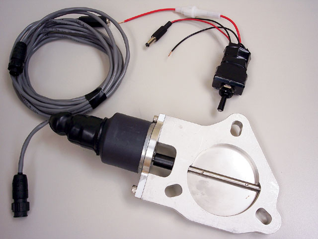

Probably the best thing is to get twin adjustable electronic valves. Keep it 3/4 closed in town and for MOT tests and wide open for the track. Also if you add the V-band clamps after the electronic valves, you can replace it with very restrictive 1.5" resonated pipes. But I think the valves alone should help keep the noise levels down.

You can mount the actuators in any orientation, so the gap between the pie and the body is not a problem. I just noticed that you said you have no room above the box, I'm assuming you meant the center muffler. I don't think you mount it there. You can mount this type of valve (attached pics) after the muffler
But it looks like the gap between the 2 pipes is small and that could pose a problem as the valve body itself is a bit bulky. You could try a mechanical valve as the valve body is slimmer.
