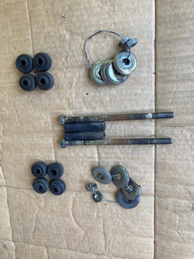

Example of item to be restored
Rear suspension bolt stripped down

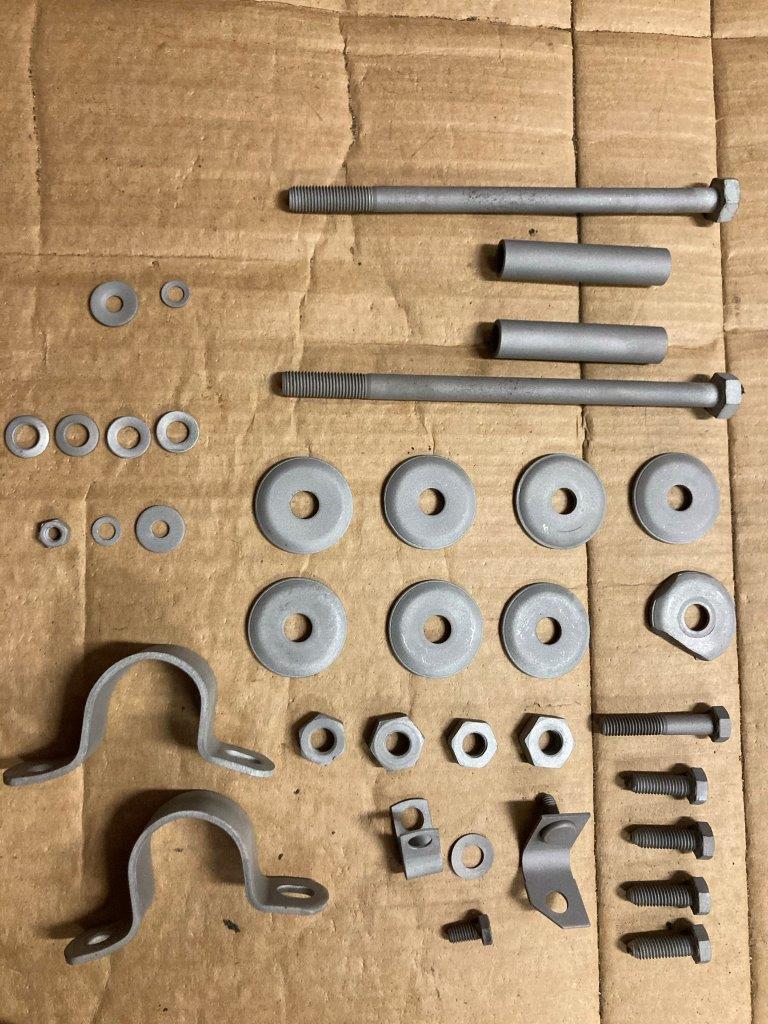

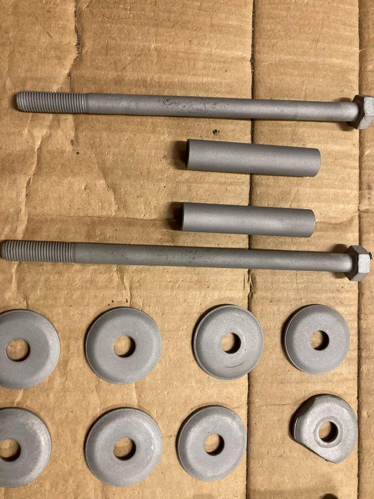

ELECTROPLATING FINAL
See comments below pictures
Items removed from tank and left to dry for 24 hours
Items nicely coated
Items nicely coated

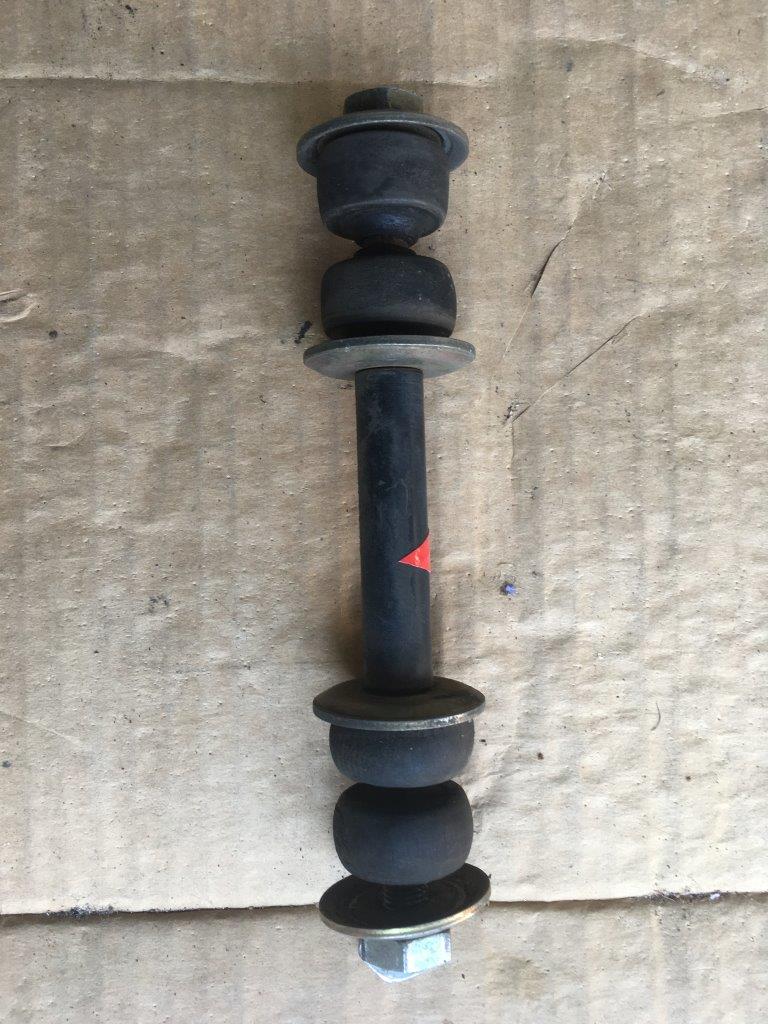

Original item re-assembled
