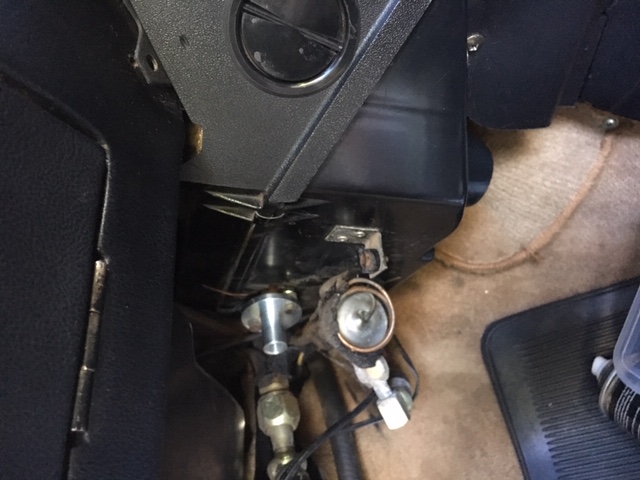

If I cut heater hose really short so the adaptor and heater valve butt up against each other it becomes firm enough to allow the cable to operate the valve without moving the unit. Now I need drain the water from engine to connect pipes up so it does not run all over the carpets.

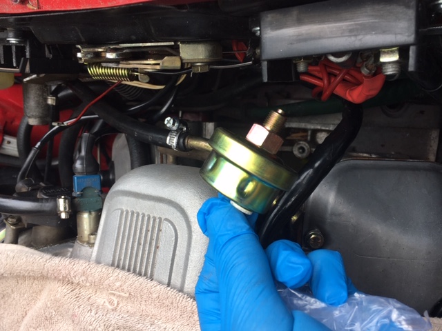

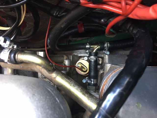

So while I was stuck under the dash ( again) after work today I fitted new heater hose to my new heater valve set up. I coincided this with fitting a new oils pressure sender unit. I could not get the spanner under the old sender unit and rotate it with the heater hoses in the way. So timing was perfect. Next time I will purchase a crows foot 17 spanner !
You can see from pic how little room their is and this is far worse on the GTV 3.0 carb car . The carbs are right up against bulkhead so nearly all skin will be removed from your hand by the time the job was done.

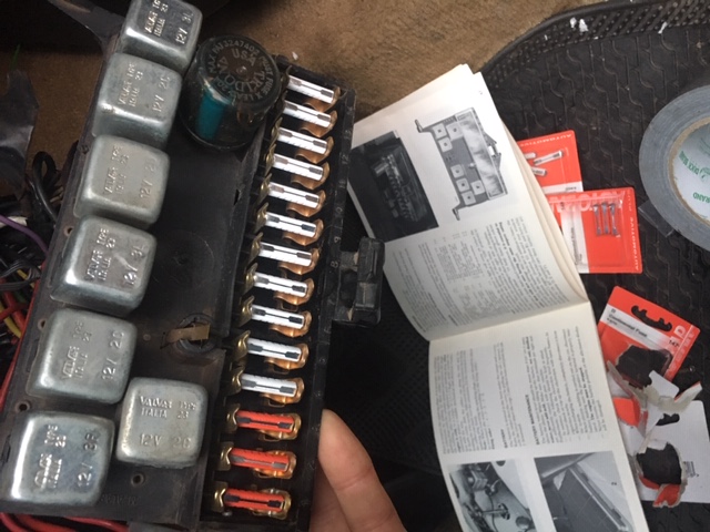

The fuse box has been cleaned up with all residue on the ceramic fuse tips cleaned. Having said that, it was in excellent shape already. New fuses as per owners manual fitted . First three 16A followed by 8A . The electric windows were also 16A.
