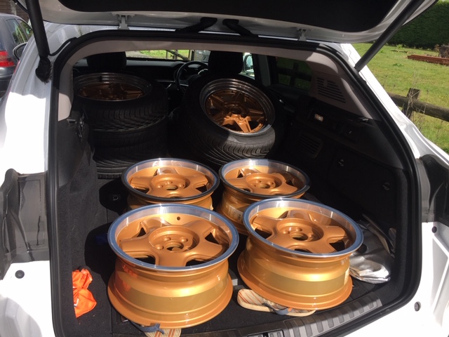

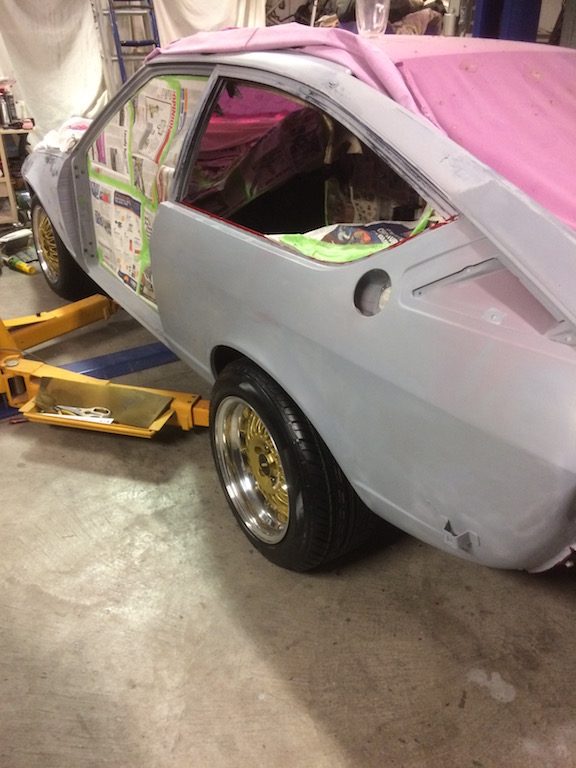

I'm not sure where this gold colour entered my head . Maybe it was from living in Johannesburg for most of my life surrounded by industry dedicated to gold mining.
Just hope Jim and MD don't get any golden ideas.
I have just finished replacing all the bolts on my FX compomotives and was about to put them on the car when my Revo's finally came back from refurbishment. So it was load up all the wheels and swap the tyres around .... again !
The gold is not as dark that most people go for ( not like MD's surfboard ) ! Code is Ford Arizona gold

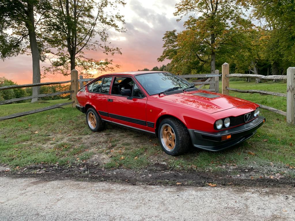

Did some test driving today on private back roads in Surrey Hills as still need to do MOT hence SA plates still on. Took a few as there was a good sunset. I need to find some decent 63mm wheel centre caps .

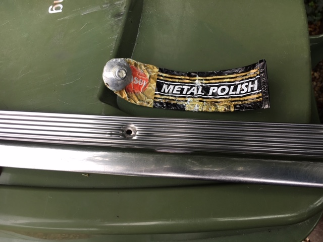

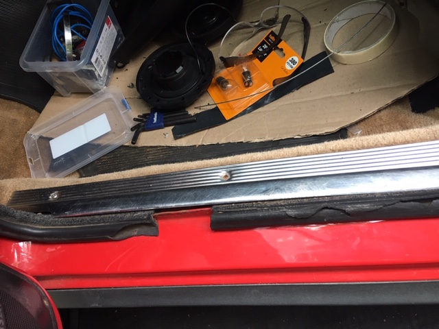

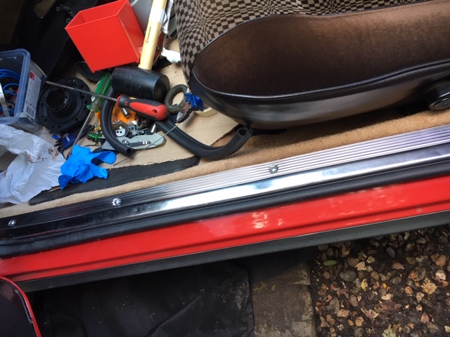

Once I got the car out its parking space I could open up the doors and change the door rubbers. Door Rubbers supplied by Highwood Alfa are really good quality. They don't have the felt on it however. The doors still close nicely but you still need to let them settle ( or mould ) in position.
The stainless trim strips got a polish at same time.
Some pics of the old rubbers along with the new ones fitted.

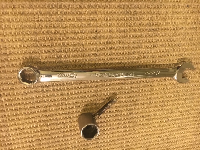

I had to borrow Georges ( owner black 75 race car) home made 17mm socket with small lever to tighten up the lock nuts on the outer adjusters. These locking nuts follow convention thread direction to tighten.

Attached is also a pic of two essential tools for working on the rear . Firstly the modified 17mm caliper tool as mentioned above and secondly the only tool to use on the drive shaft hub bolts. These bolts are usually so tight that the usual 12 sided spanner tends to round sides of the bolts so a six sided Snappon spanner solves that problem.

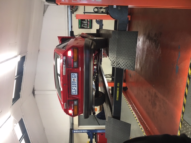

Champagne time ! The car went through MOT with no advisories or any issues. It was slightly on lean side due to fact it's from high altitude. ( Pretoria/ Johannesburg) .
I think I have got over the fact the underside won't remain sparkling and now I can get on an use it. It's rained so much lately that the idea of avoiding any mud has gone out the windows. But one things for sure its not going out when they salt the roads!
