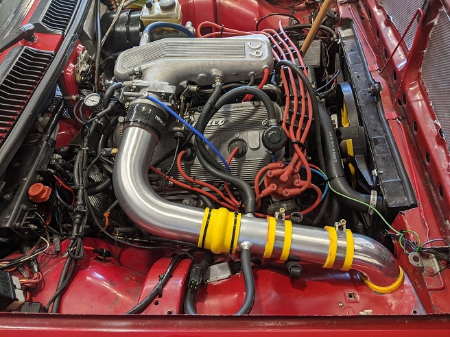

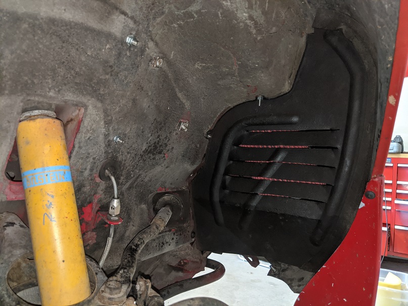

I made some improvements to the air intake system. Ignore the zip-ties, I have some proper stainless clamps on order :).
I previously had a temporary configuration with a cone filter in the same location as the standard canister filter. I saw in the logs that the Intake Air Temp was usually 30 degrees F higher than ambient, even when moving at speed. This makes sense as the filter was taking in hot engine compartment air. The change I made is to move the filter to the compartment behind the headlight. I just used a 3" hole saw to cut a hole for a 90 degree aluminum elbow. I also cut some louver style vents into the metal shield thinking that I could improve air through-flow. You can see the outline of the red intake cone filter behind the louver slits. This seems to have worked well as the Megasquirt logs show that the Air Intake Temp is now only a degree or two above ambient. The car felt faster too. All in all, the new Megasquirt is working extremely well. Feels much smoother and the improvement in torque is impressive.
