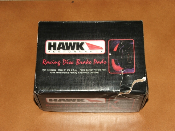

I think these are.. HP Plus by Hawke
Front Set 1.jpg (174.86 KiB) Viewed 11029 times
MD,
The HP+ is not really race pads. I had those and they were good. But if you want race you have to go with at least the Hawk Black. The Hawk Black pads ate my discs.
I guess it all depends on the type of racing you do. One of our quickest guys who used to campaign a supercharged 116 GTV used these pads and swears by them. So it may be a case of type of race and track.
I use them on the road and yes they put crap on my rims and squeal when applied gently but they stop real well.
