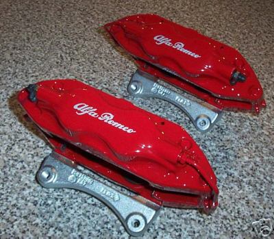

Hi all, I have been offered a set of these going spare, and wondering weather to go for them or not.Im not sure what they are worth. I currently have the RS front brake budget upgrade with 305mm/28mm thick discs and brembo caliper spacers. Would these GTA calipers be an improvement over the original GTV brembos? will these be compatible with my current discs, and what will I need to adapt these to GTV6 hubs?

Hi there, I've got the same caliper/disc combination (not yet fitted!!) and I wondered does any body already produce the billited adapters for these calipers to bolt to 116 GTV6 hubs. Any other advice on hub height and other associated modifications would be a bonus...

Grab those calipers ! Them thar things is GOLD ! :D
Those are going onto my new Giulietta..
They can also be found on eBay, new and used, I've seen several sets so far. Here in Athens some guy bought them new from AR for ~340Euros each! The best thing about them is they're monoblock calipers (one piece, not two halves bolted together).
As seen on the 159, large Monoblock Brembos, even on the 2.4 JTDm...
