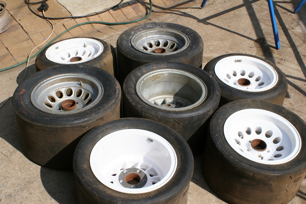

Just got these and the type 33 rims..13" jobbies.
IMG_3808 (2).JPG (126.36 KiB) Viewed 19558 times

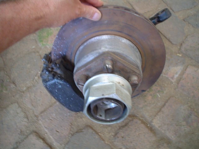

Hi Barry, what discs and calipers are those? I'm not a brake-spotter... :D

The discs and bells have Autodelta part numbers..So they were probably made specificly for the application.This whole setup came off the ex. Arnold Chatz Alfetta from the 70`s..
The calipers are Girling A.P . 4 pots front and rear.. :D

Barry wrote:The discs and bells have Autodelta part numbers..So they were probably made specificly for the application.This whole setup came off the ex. Arnold Chatz Alfetta from the 70`s..
I think I don't like you....but in a nice way. LOL Would those hubs affect the wheel spacing under the guards?
