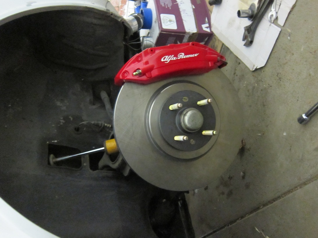

Disc + pad + caliper.

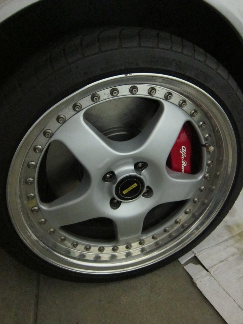

These will eventually be the wheels: OZ Racing 18x8" Superleggera 5x100 PCD, +35mm offset. With 225/35R18 tyres...I'll 'make them fit'! Plenty of clearance behind the spokes for the Brembos.

Discs + centre hats + hubs assembled.
More clearance of corners on splash guards required. Trimmed and resprayed.
Hub/disc mounted onto steering knuckle.

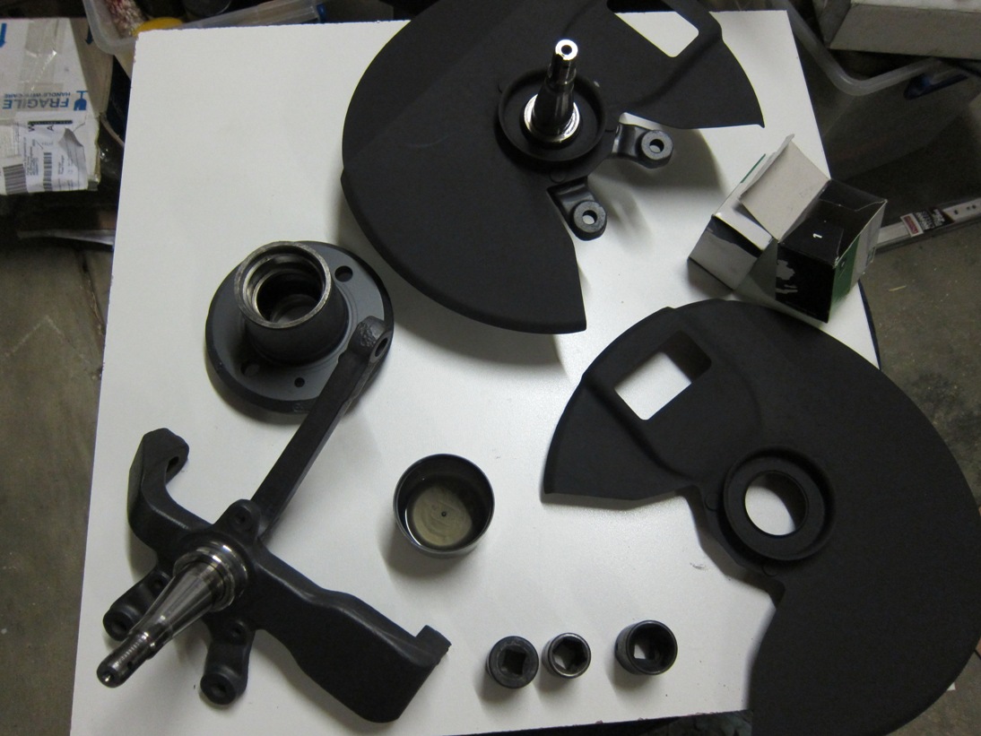

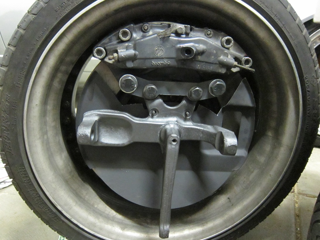

Now the caliper adapters. These were designed and manufactured by a local engineering workshop. I provided the hardware (disc/hub mounted onto steering knuckle + caliper + bolts) and they measured and produced. I can't recall exactly what aluminium they used (it's a T6 variety), but they advised it doesn't need anodizing and will not corrode. They did a good job, catering for the tapped M14x2.0 holes spaced 130mm apart, M12 untapped holes 76mm apart, radial distance and offset.
Mounting bolts are high tensile. The M14x100mm bolts are zinc plated. Without searching endlessly, I could not find zinc plated M12x40mm x1.5 thread pitch cap screws to bolt the adapters to the knuckle, so they are simply anodized versions.
Test fitting the pieces to the steering knuckle!

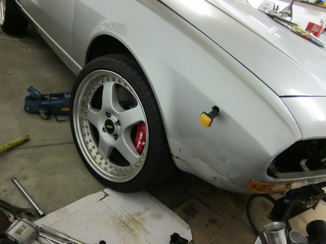

And finally, showing that the pads sit nicely over the disc surface. (Note, Brembo pad spring clip not used during test fitment.)
So, hopefully that's of interest and help to some of you guys.
I've found these forums to be a huge wealth of knowledge, and generally more 'technical' than others. Well done.

Calipers masked and ready for spraying. VHT Caliper Paint, Real Red and Clear.
Many coats of red, then cured in the kitchen oven at 90 degrees celcius for 1 hour, as per VHT directions.
Heat resistant 'Alfa Romeo' caliper decals. Carefully measured dimensions, masking tape for alignment, then applied.
Then sprayed with clear, but 'orange peel' effect on the paint.
Visible side of caliper carefully sanded smooth with 800 then 1200 grade wet&dry to remove much of the orange peel. Then machine-polished using Menzerna PO1066F polish, followed by Pinnacle Paint Cleansing Lotion and Poorboy's World Wheel Wax Paste.
Final caliper stage was refitting the pistons. ATE Brake Cylinder Paste (grease) smeared onto pistons and seals. Pistons/seals pushed back into position, and thus completed!
