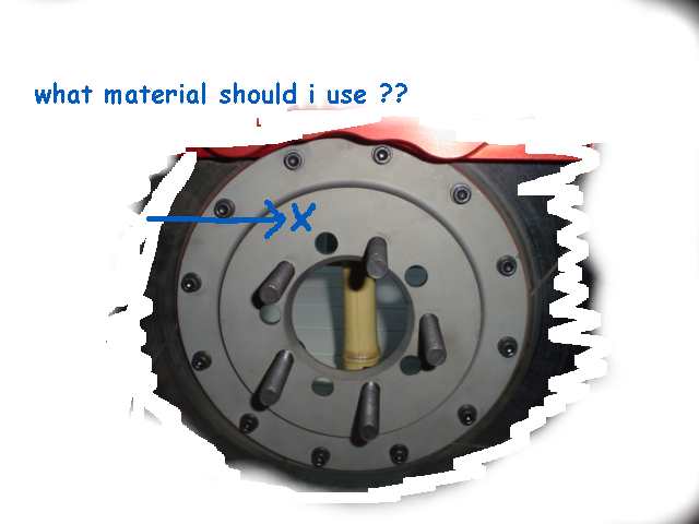

hello
if someone can give me hint tips.
for made the front rotor hats, about the material to use ?
i buy a set of 2 wilwood calipers, the 4 piston. forged.
then for the material...i'm not sure.
can i use the most common alloy that are used for machining parts on lathe...(in france we call it AU4G).
a friend works on a machine shop...so....him can made me the parts for a resonable contribution.
thanks.
gaetan
thanks.
gaetan

Gaetan,The above hats or bells I made from t6 Billet alliminium.The material must have a high resistence to fatigue -other than that there are no major criterea.Make sure your machinist uses generous radii when machining them.It cuts out possible stress raisers.We have run these ally bells on the 3 race gta`s under racing conditions and have had no probl;ems whatsoever.Hope this helps..
ok.Barry wrote:Gaetan,The above hats or bells I made from t6 Billet alliminium.The material must have a high resistence to fatigue -other than that there are no major criterea.Make sure your machinist uses generous radii when machining them.It cuts out possible stress raisers.We have run these ally bells on the 3 race gta`s under racing conditions and have had no probl;ems whatsoever.Hope this helps..
i may understand what you want to say....
if its made on common alloy, its important to made it whitout any abrupt edge...
i will fit this with wilwood 8 bolt discs.
when i finish the first draw(~2weeks) i'll show it on the topic.
thanks
gaetan
ok.Maurizio wrote:Go at least for AlSi1 MgMn 100 Hv (Werkst. Nr. 3.2315 / ~6082 ASTM) and if you can get your hands on AlZn5.5MgCu 165 Hv (Werkst. Nr 3.4365.71 / 7075-T62 ASTM B209M) that would be best, but this needs surface treatment for example anodizing.
should.../may i forgot the au4g
when you spoke about hv.....its hardeness in VICKERS ? ok...
some treatment at the points where the discs touch the hat where the bolt are placed ?

AlZn5.5MgCu 165 Hv is not very corrosion resistant. To keep the hub nice totally anodise (is always good to do that with aluminium, but its a cost issue).
Hv = Vickers
I cant find specs for au4g, but a machineshop would be able to locate the material with the werkstoff number I added.
It is always a pain to find cross references for US/DIN/Iso etc coding
Hv = Vickers

well i find some info.
my 'french' AU4G it's : 2017.
the specs:http://www.matweb.com/search/SpecificMa ... um=MA2017O
and for the famous 7075 t6 (AlZn5.5MgCu 165 Hv , you spoke maurizzio)
the specs:http://www.matweb.com/search/SpecificMa ... m=MA7075T6
looks like the au4g drives me on a wall
2 stroke addict

Perfect ( www.matweb.com ) this is alway my first and best place to look first! But couldn't find you 2017 .............tectoteam wrote:![]()
the specs: http://www.matweb.com/search/SpecificMa ... um=MA2017O
and for the famous 7075 t6 (AlZn5.5MgCu 165 Hv , you spoke maurizio)
http://www.matweb.com/search/SpecificMa ... m=MA6082T6 must be available at every self respecting machine shop.
