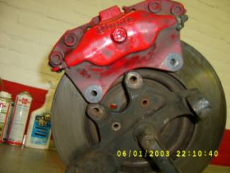

Having dismantled one of my front hubs over the weekend to have a good look I've just realised I was being stooopid! In that I didn't look closely enough at some of the pictures in earlier posts in this thread before posting an earlier question!
OK, I have the exact same callipers as Lenz & his last picture above shows the problem - the mounting lugs on the calipers interfere with the mounting lugs on the hub. Such that the calipers can't get near enough to the "centre" on the hub for the 305mm GTA disks, let alone the std disks (unless you use disks of about 350mm diameter
I re-read Barry's posts and studied his photo of the hub on the car.... I now understand Barry's fix is to cut the lugs off the stub axle and re-weld them where they'll be in the right place. I missed this earlier - I was obviously suffering brain fade rather than brake fade!
OK I still have a problem in that I don't want to cut and weld the hub carrier because otherwise I can't go back to stock if I don't like what I've done for any reason.
I did lots of measuring up and I'm now thinking of milling two partial thickness "pockets" into the calipers so that the stock hub carrier lugs can intrude into the caliper allowing me to make a staightforward adaptor bracket to bridge the 4 mounting holes. The areas of the caliper where the pockets would be contain no fluid ways, obvious voids or bolts. It's just solid webbing and I'd make sure the inner cut edge of pockets would be radiused (to avoid leaving a stress focusing edge).
Any comments?

Jose, i cut off the ears of the upright and machined the surface and than a steal plate was welded to the upright.

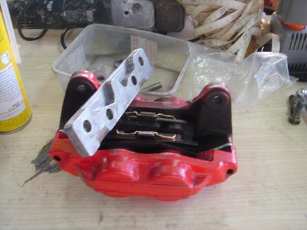

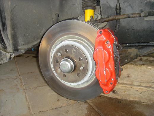

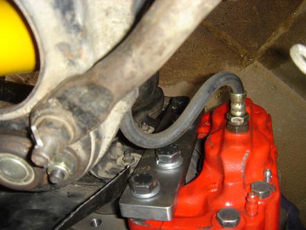

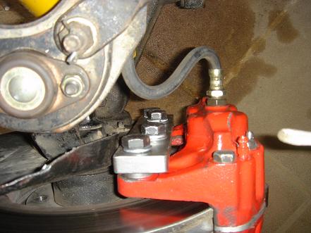

I think the best solution for those wishing not to cut and weld the stock mounting ears is to laser cut the part that is tauching these ears exactly in the middle between the ears of the GTA caliper , the caliper will also have to sit like in the picture Lenz posted above , so that it could get closer for that extra 20-15mm between the centres on of the two pairs of holes (by radious of course).
Check out my setup , these aren't GTA ones but very close in mounting holes confi' ,and that's how the calipers ears should look like after the machining....

Thanks "Guilietta", seems like the best approach to me as well. Point noted about mounting the caliper either up or down from standard location and just cutting one pocket, the less material removed the better I'd say. I now need to figure out whether up or down gives more clearance for suspension movement or full steering lock- sounds like some more measuring tonight!

It should work fine with a good milling machine and skillfull hands,
I suggest you first calculate how much metal to mill from the caliper (I would clear to 5 mm from edge of the pads)
Then decide if mountin up or down , I would choose the location as far as possible from front anti roll bar so that the brake line entrance will not come close to the upper (of the "scooters") bush of the roll bar on hard cornering .
Then you could either measure the holes distances with good electric tool while caliper sits on disc while pad clears good from the edge, or go with a computer software and calculate the distances in the adapter according to the changes from the centre of the assembly on the radiuses and from bore(not verry easy but most accurate and possible).
Good luck!
Good luck!
