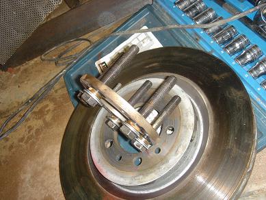

also,
i think about this solution (image 2) to keep the bolts on place, in order they dont move.
one another bolt that 'hold' the first.
sounds easy and cheap.
because my hats are already done...and i have to modify them...

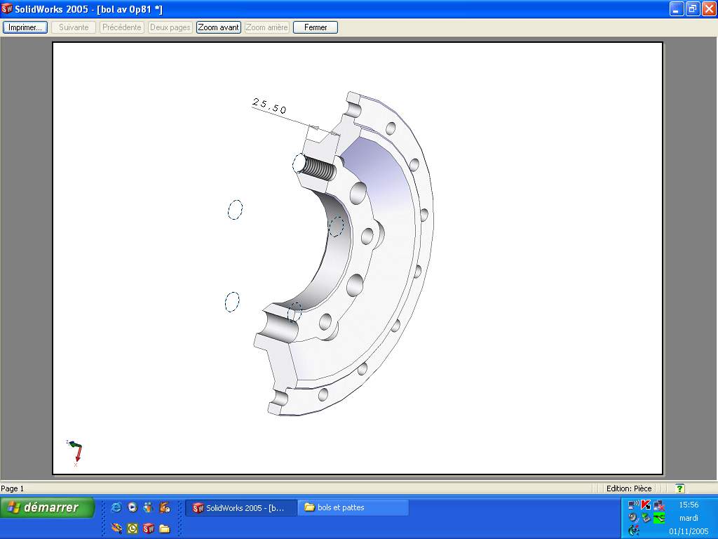

WHY:
i make hats that keep the disc closer to car far to wheel.
in order to fit big brake on small wheels.
but this oblige me to make hats with a big thickness.
cut view of my hats.
<br />25.5mm of thickness + hub + wheels +nut make a very long bolt....

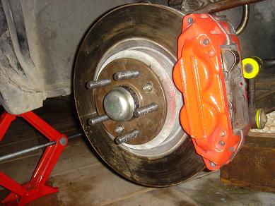

Hi all,

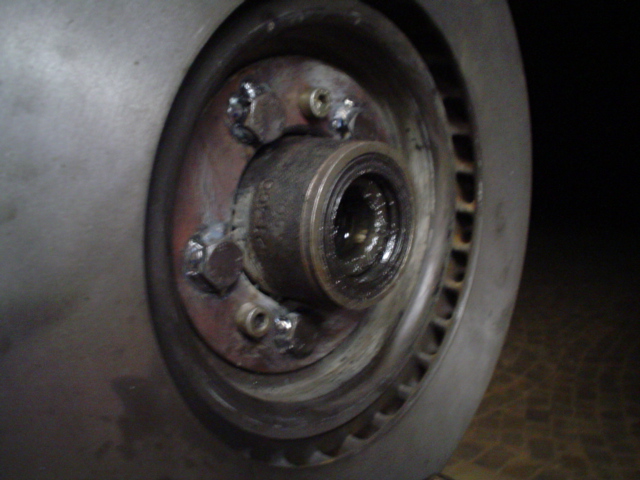

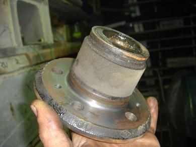

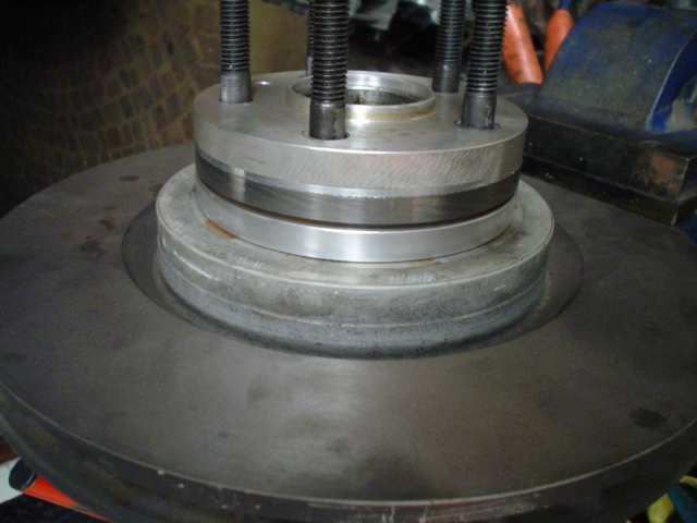

I have adopted Barry's method of the wheel bolts transplanted as studs into a matching 1.5 pitch instead of my old style bolts coming from the whee'ls side into the steel plate I had made from behind the GTA disk-works great!!!!
No more rattling at high high speeds , no more released bolts after a hard drive !
Only changes I did was a thicker machined steel plate with the 5 bolts pattern with 1.5 pitch and 2 small studs for disk easy mounthing, I also machines the hub's rear surface a little and had it balanced on a VSR .
Blue hard type locktite and machined 6mm ccne washers totaly prevent any backwards response of the bolts at the rear when closing on the wheels-cheers Barry:)

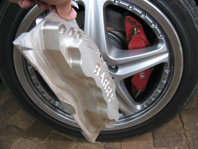

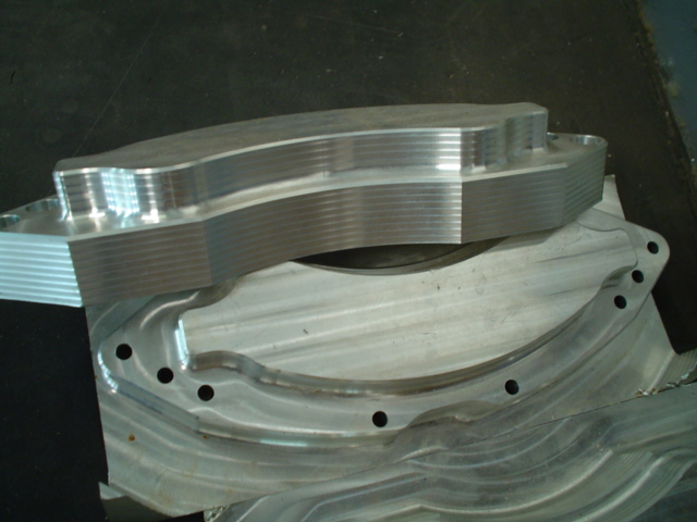

While looking in Barry's waste bin, (dont ask why) I have found proof hes up to something. Check this out.
Hey Kev,yes,those are actually scrap-and we were playing on the NC machine with differing letter types,hence the name on the caliper.Fooling around with this.We machined everything and then could not economically split the 2 halves!!!
Thats why they ended up in the scrap bin..
We are now using pre split half rounds to machine the calipers..
For those of you that would like big brakes and still use your 15" wheel,Im busy with a race car at the moment..
The largest disc you would be able to fit is a 300mm diameter..And then you would need a narrow bridge caliper such as the small Brembo 4 pot.
Pad size 110mm x 50mm x17mm.
Kev,check it out and lets do yours..

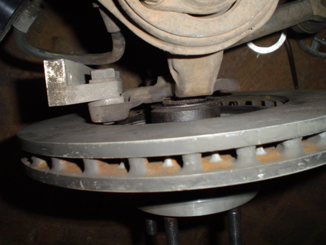

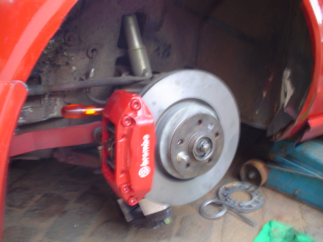

To clear the rim ,I had to move the disc as far inwards as possible.The gta disc got a 10mm spacer behind the hub as well as a 10mm sapcer on the outside..As the discs need to be changed quickly,The stud girdle unbolts,the studs are pulled out and the disc remaved/replaced.All the other stuff stays attached to the hub,so you dont have a zillion things falling of when you remove the hub..
