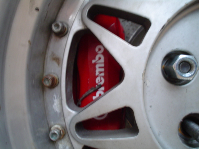

Jim,This chap is using old original ,I think,Gotti race wheels on this car.Im also making them fit the Compomotive cx and fh split rim.
I cannot get a 305mm AND the caliper in there..Ive just fitted a std Campagnola gtv6 rim and I can tell you that it does not go over the rim either...
Maybe a more modern rim will go over bigger stuff...its posible,but 328mm???????????????????????????
See all the q marks??you sure,Mr Scnitsel??

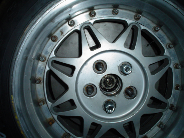

These wheels,btw,are Speedlines,not Gotti`s..They also have NO place to fit a half descent set of brakes within them..damn,I had to cut the 310mm disc down to 297mm AND mill some off the Brembo calipers....
A bitch wheel if I ever saw one....
Everything fits perfectly under the std. 30l Compomotive without any mods,but the client wants the option of both sets of wheels..

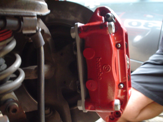

- DSC00042.JPG (152.27 KiB) Viewed 10172 times

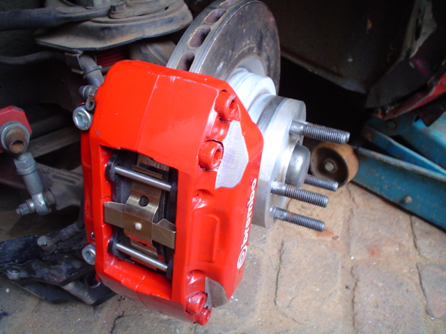

I'll try to post some pics here, lets see if it works out.
- Another bracket idea for Brembo Reds.
- P2240005a.jpg (126.49 KiB) Viewed 10132 times
- Note caliper spacers to allow 32mm thick discs.
- P2240001a.jpg (116.5 KiB) Viewed 10134 times
- Assembled view.This is good for 310mm discs.Bracket can easily be modded for 323 discs.
- P2240004a.jpg (109.97 KiB) Viewed 10136 times
