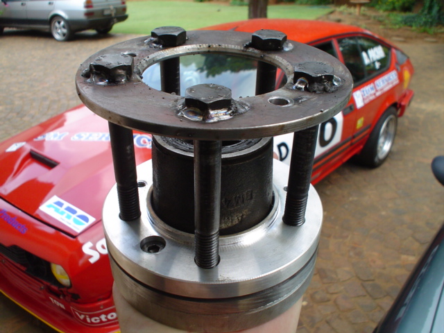

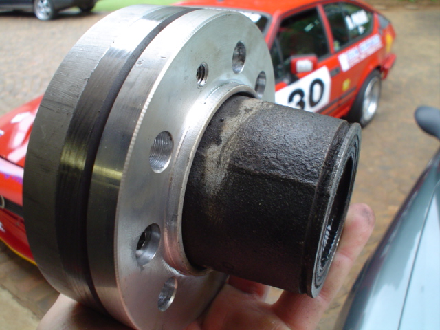

Tomer,I take the center spigot out from 58.8mm on a gta disc to 78mm and also to 85mm...The race brakes I just did work very well btw..These I took to 78mm..And look at the ally spigot used to center them,2mm material ONLY !!Its all in the clamping force,not in the spigot...
The spigot can be seen clearly here..This whole assy is bolted together..no million parts on the floor shit when it comes to changing the discs....
:D While Im on a roll here,the stud girdle is a one piece affair,it gets pushed back through the assy. after removing the 2x 8mm hold bolts.The disc is then changed and the stud girdle is pushed back into the hub assy and the hold bolts tightened .. :arrow:

Barry wrote::D While Im on a roll here,the stud girdle is a one piece affair,it gets pushed back through the assy. after removing the 2x 8mm hold bolts.The disc is then changed and the stud girdle is pushed back into the hub assy and the hold bolts tightened .. :arrow:
Welding on hardened bolts always makes me nervous :S

Zman,If you try welding ht bolts heads to cast iron...it will fail 100% of the time..Thats the reason for the 5mm mild steel ring....Ive just had a cast iron ht bolt episode that had to be sorted..the bvery same race car I did the brakes on here...
