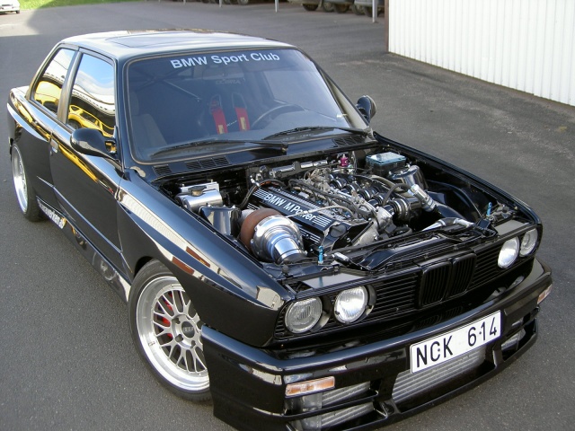

Then there is that insane m3 trbo with 800hp or sumptin...crazy,but more fun than a barrel of monkeys....The video shows 380 odd hp without the turbo on the dyno...8:1 cr!!!!!!!and then they bolt the turbo onto that thing...
Micke,you know about this car??its from your neck of the woods somewhere...
Do not mess with this...it will hurt you bad...

wow , that is an insane car , the IC goes all along the bumper and is about 5" wide,this thing literaly smokes tires for breakfast like drugs addict- or better say Drags-addict) ...hell yeah you're piss%^& all over the Brakes thread Bazza:)
Chen S
ex Giulietta 24V Glenwood TT.
Chen,Have you seen the video on this thing?????? Its beyond insane..Ive chatted to the owner as he uses a simmilar sealing ring as we do..Had a problem on Hamishes engine not sealing..
This is a car to be respected big time..it will eat you and spit the bits out later..

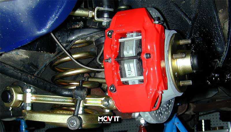

Move-it brakes for the Giulia 105..
final camera day 171.jpg (88.03 KiB) Viewed 10913 times
Breaking (braking??) all off-topic records here, In The above 105 brake pic, you can see the short swaybar link that can be used in lowered gtv's/75's, in place of the long original 116 one (unless you go Unibal that is)
