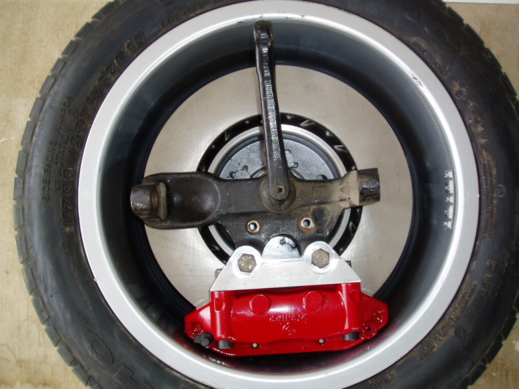

Am very interested in your Giulietta 2.8's rear brakes! Any photos?
Z,My rear setup-155 v6 discs and 164 frnt cal.Too much with the 164 cal.The std 155 or 156 rear cal will be better.

Sorry,That should be picture 030............
Picture 030.jpg (147.8 KiB) Viewed 17025 times

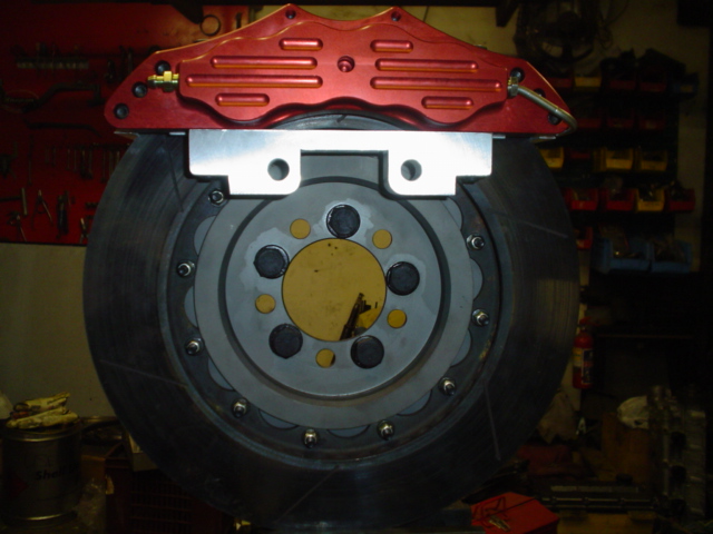

Barry - nice one mate :wink:
It's nice to see the kits actually fitted on the cars! Wait 'till some of the guys here see what you've done :D
I really like the fact you've used factory 305 and 310 mm "BREMBO" discs, the Brembo castings are the highest quality casting around, and have high carbon content. This makes sense as it keeps the cost down ( nice) and the discs can fit under 15' wheels, which had not been general infomation previously.
Why go to the expense and hassle of massive 330mm+ discs and alloy bells on a gtv6/75?? With these powerfull calipers, it's really just overkill in my opinion, as 305 310mm are more than enough-even for racing....
Andrew
8)Andrew,yes,well what do I say.....
Kev`s` car is amazing in the stopping dept.When your`e over you must drive it.Let me know via mail as to the magazine arrangement please .

N,No,they dont bolt on.You have to make a mounting adaptor.

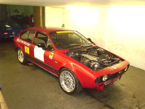

Might be needing some of those for my new "toy".... I'm sure you know this car very well!!!!!
ex glenwood - ex rare motorsport UK - now mine!

Andrew.b wrote:Barry - nice one mate :wink:
Andrew
That was what I was going to say... :)
305 is plenty unless you have too much weight. :lol:
Big rotors just add weight and inertia, eight pot calipers? :roll:
I just hope my 15" wheels clears the 305mm discs and calipers. That would be sweet, cheap(ish) tires and light rims.
Andrew,I know the car well.The shitty engine bay spray job?I did it with a couple of spray cans bought from the hardware shop at Dawies place.He neede a "very quick "spray job done,like in 3 minutes before the engine went in!!For a moment there I thought you had Julian`s 75!! Now there is a car I would trade grandma for........
Mats,The cals(8 pots)and 305 discs fit into a 15" rim no prob.If I recall,Jim K also fitted his e-bay Brembos and 300mm discs into Compomotive wheels for his 75. 8)

Julian has sold the original 75 he raced from 1999, that won everthing!! had various 3.3 3.5 3.6 3.7 engines!!
Was sold to another UK Alfa racer. Yes the TT is a little untidy in the engine bay, but i've got plans :D. For the price I paid, I could not say no! The wheels are worth more than I paid for it :D :D
Just needs some better brakes :wink:
