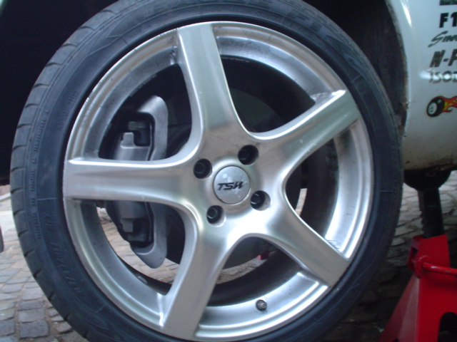

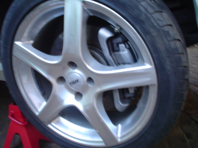

Just done what I ragard as the best brake upgrade for the money on a 116 GTV..
2007 Audi 20l Turbo calipers AND discs!!!!The discs are 315mm and the hat offset is identical to the Alfa GTA disc!
The caliper is super slim,hence the rather large construction of them.
Brilliant performance!!Id say better than my Brembo`s and GTA discs on my Giulietta!
mmmmmmmm.......lousy pic..Ill update with some more...
