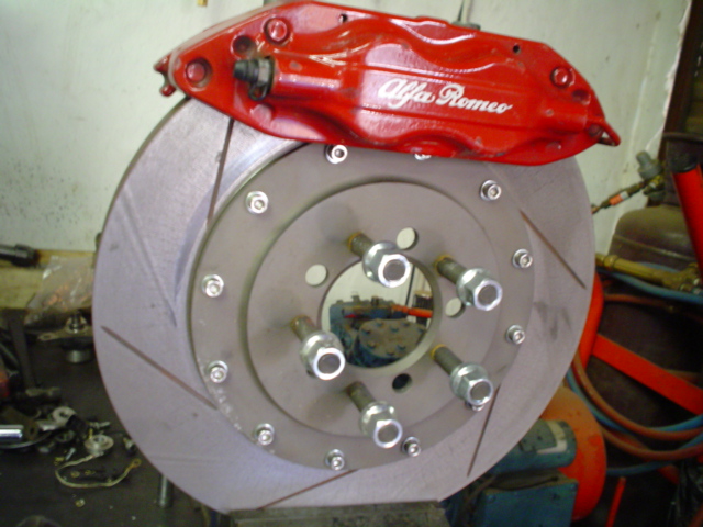

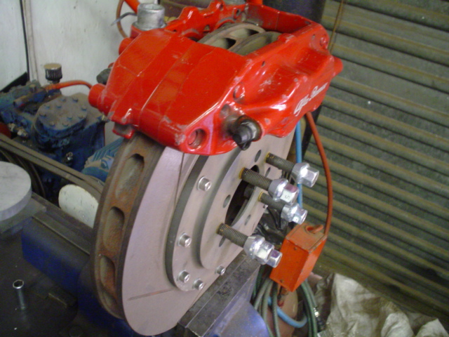

Short question. Sale is pending. I have possibility to buy either used Brembo 4 pot calipers or gta calipers. Which way would you guys go? I really want to keep 15'rims. (yes I have read the whole topic yesterday)
thanks,
Pete
Pete,GTA Brembo`s are too big for a 15" wheel..Try the smaller GTV Brembo ,that will fit with a smallish disc..
Pic is GTA Brembo`s for my new Giulietta.
8)
What will work using a 290mm disc is Alfa 166 Brembos..
8)

Thanks Barry, I guess that 166 calipers showed up for the first time in this thread. Which rotors should I look for? Any readily available or custom work?

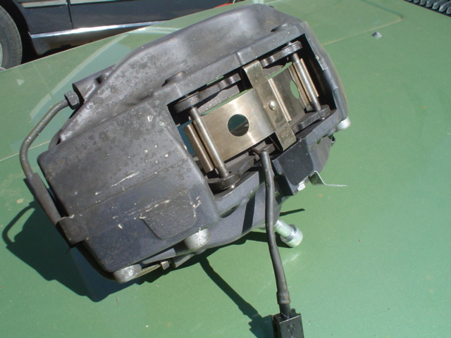

Gee I guess you re not too concerned about scratching that green gtv are you :D?
Pete,trust me,they were meticulously put down on that bonnet.Not a blemish..
I would look at BMW E30 front discs..Ive used them with Volvo cal`s before and they are very good.

the original calipers only work with big discs if you use a spacer. I have 305mm rotors, 28mm thick (166 or 159 I think) with the original gtv brembos, by way of replacing the original spacer set in the calipers, with thicker ones.

But, I have dug through catalogues and found out that the biggest rotors available in E30 (M3) were 280mm :?: Is it worth the hassle to go with just 11mm larger rotors? Or I just cant find the 290mm ones? (which is likely, never been good at finding things :lol: )
