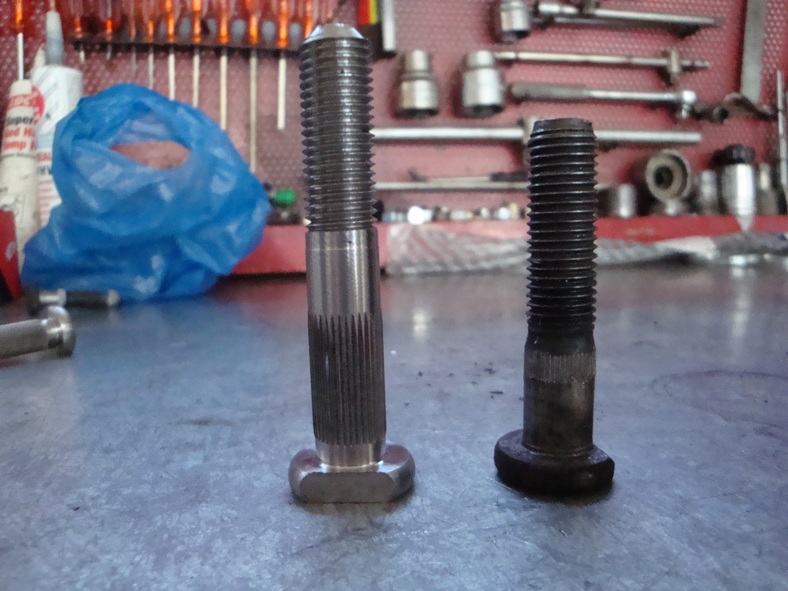

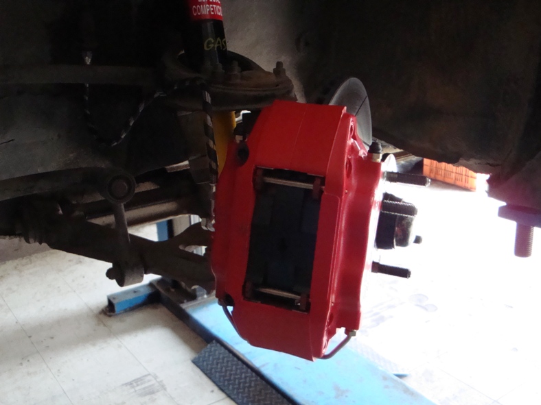

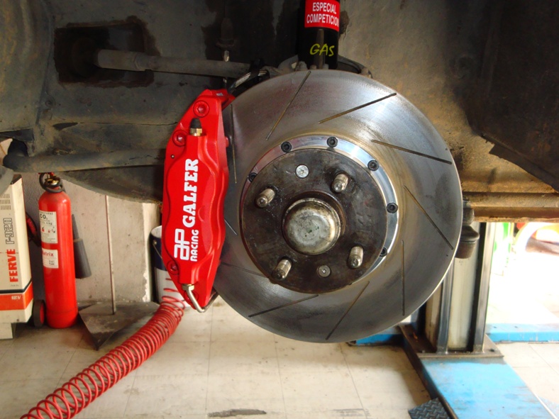

One more type of brake upgrade which i consider enough for street/trackday application on any non-turbo 4cyl GTV:
285X22mm discs and AP Racing/Galfer 4pots on custom CNC machined alloy bells and longer wheel studs.
The setup fits the original Campagnolo 15in wheels perfectly (without spacers) but it did need 8mm ones to clear the Ronal Turbo 7x15 wheels.
Considerable improvement in stopping power versus the previous setup (gtv6 Brembos and 265x22mm discs). 8)
X
Front discs (1).JPG (165.98 KiB) Viewed 9448 times
Front discs (2).JPG (144.47 KiB) Viewed 9449 times
Wheel stud comparison.JPG (148.51 KiB) Viewed 9446 times
