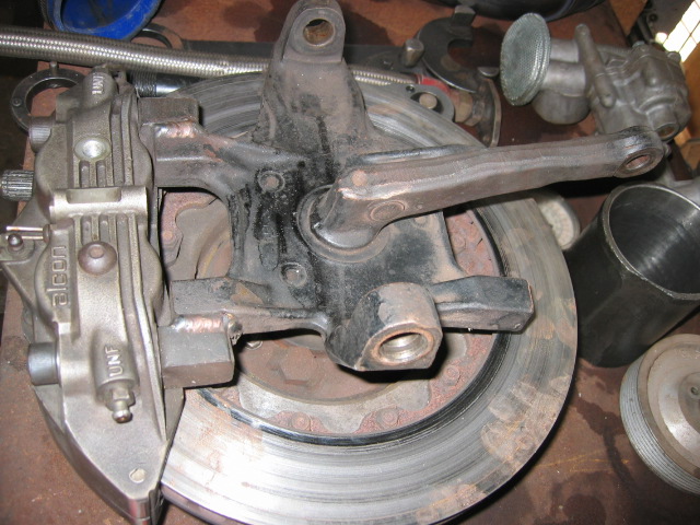

Not on the topic of rolled threads but here are some classic auto delta double caliper hubs. that have lugs welded to for ap calipers.

Re: Some more brake upgrades for the 116-Barry
There was a guy btw, who was selling these exact double caliber hubs (NOS) in E-bay a couple of days ago for about $2.000 if i remember well...
X
X
These are definately not for sale. I must measure the bottom balljoint to centre hub to see if they are same dims as SZ. These were brought into SA in 1982 for touring car champs.
