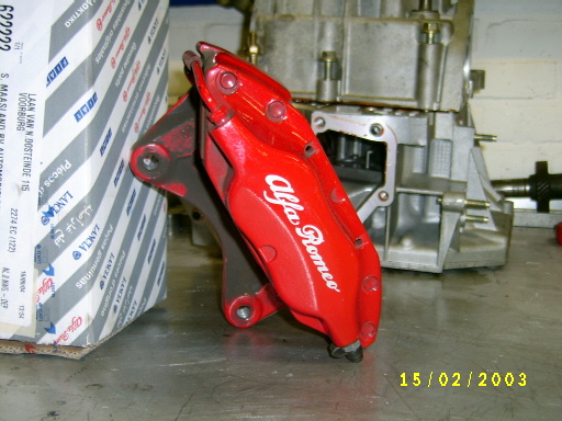

Mr Norway,Just got off the line to Praggia.The 6 pot midi is what you require for your std 285mm disc.The pad size is 120mm (same as my Lancia Brembos). This is specifically designed for a disc of 285 to 295mm.x 22mm thick.

What caliper you intend using??I used a set of Lancia evo Brembos amongst others..This is how I fitted the Brembos.
Put pads into the calipers and fitted them to the disc in the correct position.Id previously fitted the calipers with fittings so I could clamp them to the disc by using compressed air!This held the caliper firmly where I wanted it.The calipers had the mounting "ears" from the stubb fitted wich had been cut off earlier.
I then used 10 x 10mm square bar to make filler pieces and tack welded them together.Use short welds either side as a one sided weld warps the mounting and pulls the caliper over.Short tacks either side solves this problem..Remove the lot and paint .I fitted new bearings ,seals etc.and assembled all.Finito.

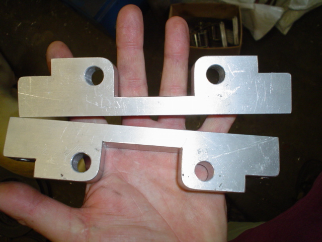

In the same pic you can see the ally adaptors I used to fit the radially mounted A.P.Racing calipers.The praggias use the same type of adaptor.

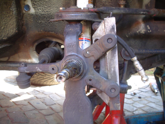

The radially mounted brackets for a gtv6..

Barry i'll be using the 147gta 305mm set up with the brembo calipers.
The conversion looks pretty straightforward but the hardest part for me will be the adapter to fit the brembo's to the 75hub.
Welding won't be an option for me because i don't have the proper materials to do this and my (mig!) welding techniques aren't that good. I'd rather use an adapter.
The 75 mastercilinder doesn't match the dimensions of the 147 gta master (22mm - 15/16inch=23.8mm), did you change the gtv6 master cilinder?
