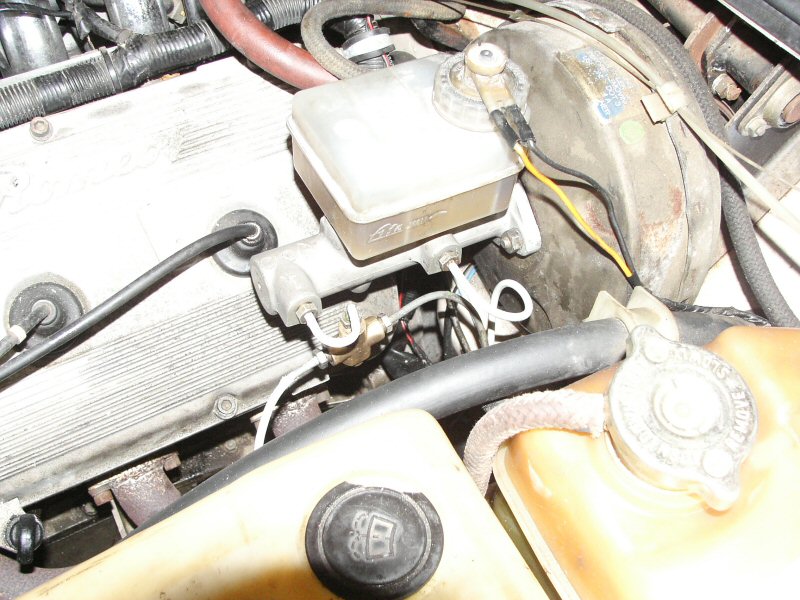

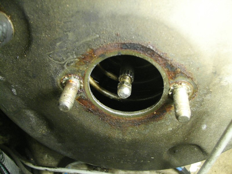

I finally did this conversion on my Dads car to match the 4 spotters and 295 rotors on the front. It works well !
The simple solution to taking out the pedal slack is to get a booster with adjustable rod length :shock: - I'd never seen one until this one !
07-12-30 009.jpg (116.99 KiB) Viewed 17996 times
BMW 750iL 25.4mm master cylinder and reservoir
07-12-30 005.jpg (121.83 KiB) Viewed 18001 times
Booster with adjustable rod !!
07-12-30 002.jpg (101.11 KiB) Viewed 18002 times

Daniel the booster with adjustable rod you have comes from a BMW? If yes does the booster bolts straight on?

The master cylinder you have there looks correct, just remove the hydraulic booster. The cylinder size is marked under the reservoir. From what I could find, the 25mm cylinder was only fitted to the 750 series BMs, the 730/733/735 only had 23mm ones.
The booster on Dad's GTV is genuine original 1985 Alfa.
