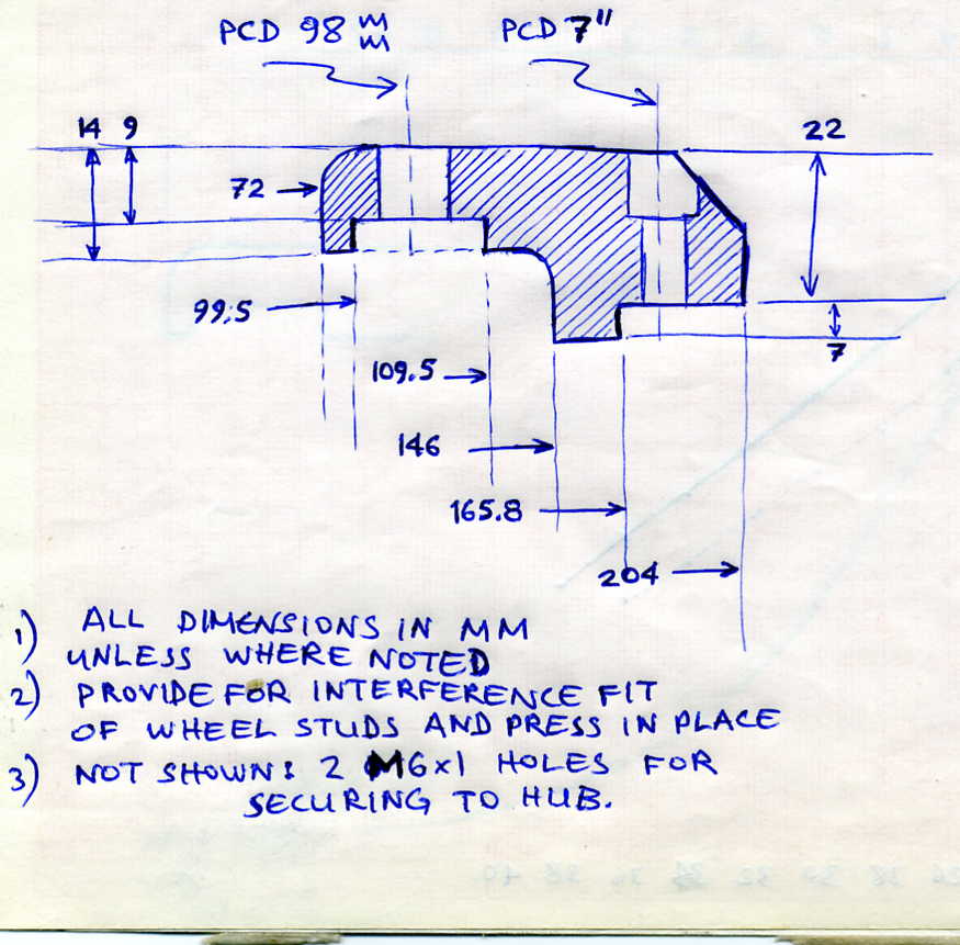

Turbotim, I'm working on the drawing and will post.

On another note, addressing more civilized forum members, here is a section drawing of the bell.
Horizontal dimensions shown are diameters!
