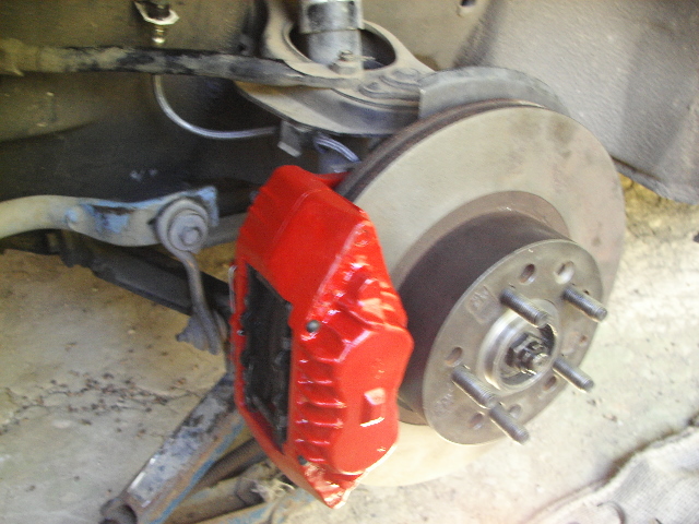

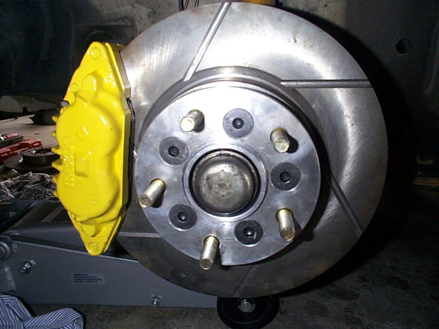

Ok, the ones I have done are -
1. MA71 Supra rotors (300mm x 22mm thick) with ser 4/5 (FC) RX7 calipers - this will fit (with some effort) in standard GTV6 15" wheels.
2. Ser 6 (FD) RX7 rotors (294mm x 22mm thick) with ser 4/5 (FC) RX7 calipers - this will fit in standard GTV6 15" wheels.
I'm currently working on a set of Skyline R32 GTR rotors (296mm x 32mm thick) and calipers which should be finished in the next month or so. They look like being 16" wheel or larger fit up.
Ultimately I would like to combine either E46 M3 rotors (324mm x 28mm thick) or R33 GTR rotors (324mm x 30mm thick) with Porsche 928 S4 calipers. These would fit my 16" wheels but only just, probably really require 17" wheels.
Hope this helps. Let me know if you want more info.
- FD RX7 rotors & FC RX7 calipers
- New brakes.jpg (209.28 KiB) Viewed 8181 times
- Supra rotors & FC RX7 calipers
- Big brakes.jpg (112.49 KiB) Viewed 8179 times
