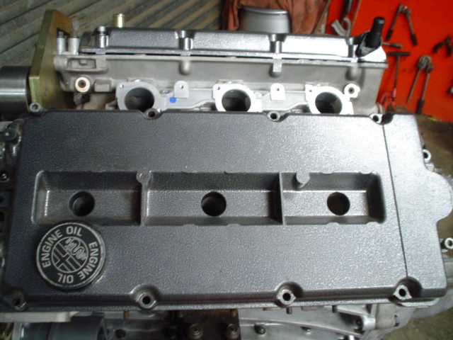

Thanks for the input. We are moving the cap to the front. A welder is going to fix this issue and the engine is apart as we speak. Going to have the GTA cams intalled and then pictures to follow. Jungle Justice is helping me accomplish this since I don't have enough skill to transfer this myself. I guess we could do it down here but since it was included in the price of the engine I guess I am just lucky.

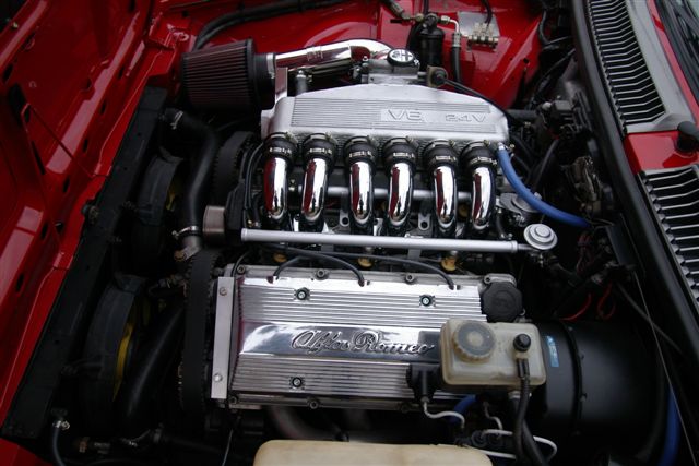

And WOW Brian, your engine install looks so nice and tidy and clean! I want mine to look like that!
With your coil pack, did your plugs fit properly?

Hey Bernard,
The fit of the plug leads to the VR6 coil pack isn't good at all. One option was to get the local Bosch guys to refit proper connectors. But I took the short cut and super glued them in
Figure I wasn't going to remove them in a hurry. I noticed your mechanic taped them around the coil pack.
Hey Bernard,

Tell me about it, very dodgey.
I might get them re plugged. Its a pity the GoTech wont support individual packs.

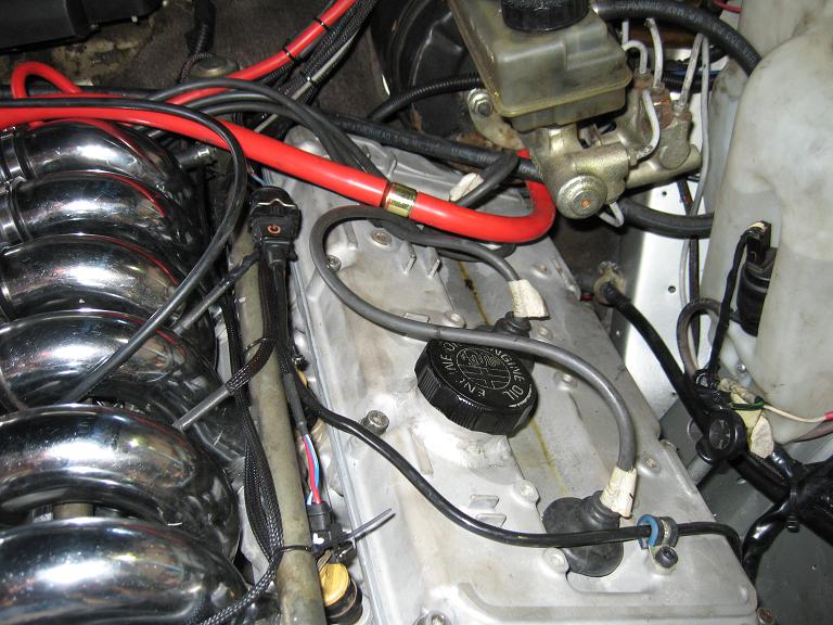

I was looking at the remote dual-booster setups on the older Bertone GTV and other 105 cars and was wondering if there was some sort of a remote booster option that will allow for an after-market/remote setup to be used on a GTV6!?
As far as the options from the cross-referenced boosters mentioned before (BMW E30 etc), there is one major issue - the clutch-master!
On the two 3.7 Milanos this is not an issue - we're converting from boosters to dual master set-ups with adjustable bias-bar adjustment.
On the US-model Milano Verdes and Platinums with ABS the 24 valve heads also clear the compact, square ABS set-ups just fine!
On the lower-end non-ABS Silver and Gold model Milanos, as well as on all GTV6s, that standard Ate booster sticks out too far and hits the left-side head!
In SA a simple swap to a BMW E21, E30 or any of the other boosters mentioned solves the problem, since a flatter booster now stays behind the heads and the larger diameter does not have any obstruction.
The reason that the boosters from these various cars fit so well on RHD South African and British GTV6 cars is just that - they are right-hand drivers! (The clutch masters on those cars are positioned just ahead of the driver with a weird linkage over to the passenger-side - LHS of the car - to operate the brake booster mounted remotely over on that side! (It is the same Ate part number 3.6127-0801.4 part - 124 1 H5F - as on our base-model US cars, but operated remotely!)
The larger diameters of the flat boosters don’t hit anything!
On a US and European model GTV6 for example, the clutch-master is mounted right next to the relatively long (small diameter) standard GTV6 booster (BOTH just ahead of the driver on the left-hand side!) A larger, flatter booster solves the head-clearance issue, but it hits the clutch master - you're trading one problem for another.
I know that there are various combinations of Alfetta pedal-boxes and 164 boosters that solve this problem, but I sure wish that there were a flat, small diameter booster with the same diameter of the standard GTV6 booster so that it sits flatter to the firewall AND still clears the clutch-master right next to it!
Brian/Bernard - I noticed that you guys still have the stock boosters on your cars - and yours are RHD!? WTF? On Chuck's car the booster hits A BUNCH - no fit possible there - and the oil-filler neck IS moved!
