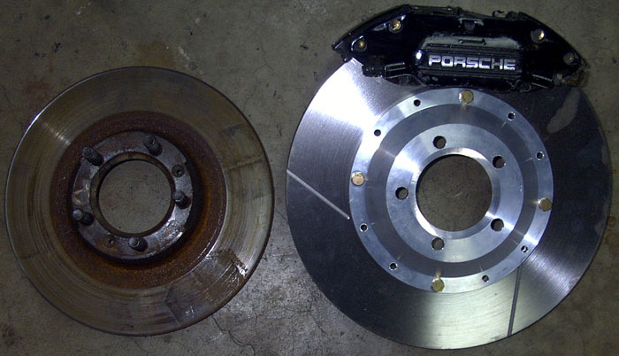

Hey Guys:
My big brake kit arrived at last!
The disks are 310mm and will use a spare set of 1987 Porsche 944 Turbo calipers. Yes, I'll grind off the Porsche badge before fitment and likely paint them red too :) These are 4 piston Brembo calipers and are well proven.
I'll post more pics when I install them ... and see if they will fit under my 16" wheels :shock:
For now, the plan is to use the standard master cylinder and potentially install a brake bias valve. I also have the rear brake kit on the way - installing the SZ Zagato (ES30) vented rear disks and caliper spacers.

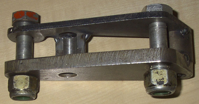

What is the part in the 1st picture? Is it the caliper mount?
Guy

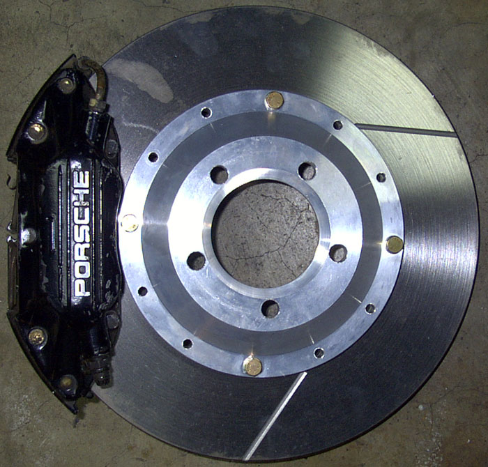

It all seems to fit nicely:
These are 16" wheels - I reckon the disks are a bit too large for 15" wheels. All that still needs to be done is to figure out the plumbing. I'll have to check out how the brake line is connected to the caliper in the Porsche - it helps to have the latter sitting just one meter away :)
It all still looks a bit grimy - I'll rebuild the caliper and repaint it and the bracket before completing this installation.

looks like some serious stopping power there mike... mind you the old disc looks like it has been battling to do its job

also michael,in my opinion; fit the cross over tube down instead of the top of the caliper.
if no, should be a headacke to bleed the brakes.

Great point in regard to the cross over tube - I'll switch it.
I'll take some measurements for comparison before installing finally. The 951 caliper is very light - comparable to the stock Alfa caliper probably. The disks are obviously a lot heavier, but its got an aluminium hat which helps keep the weight down.
Installing the SZ disks tomorrow :)
