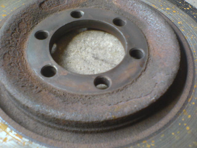

Note the thickness whrere disk meets the diff flange and cv joint flange:
Sorry for the quality of the pics, but it's my always-handy cell which has meet the ground far too many times...
Anyway difference between the two is 3mm :!:
So if you re tightening that bolts and that rotor is still loose... Well buy a proper thicker rotor or grind off some material from the CV flange
Early type rotor
Early type rotor
