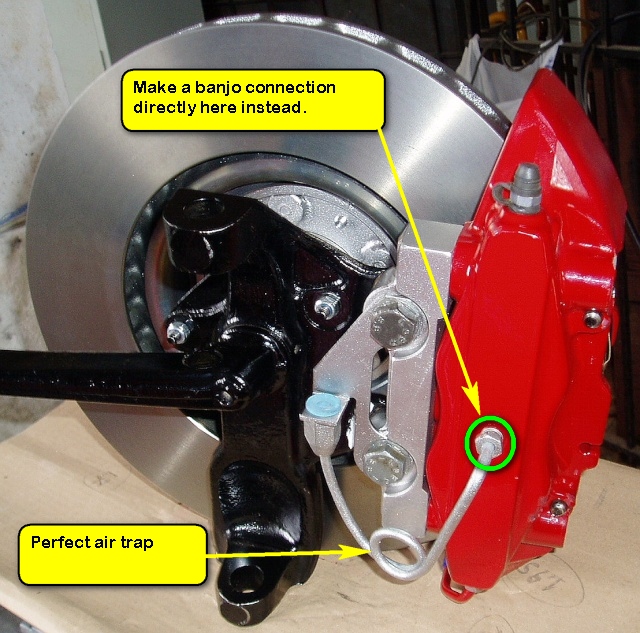

After a lot of measuring and mock-up work, I concluded that 15" Compomotives will accept a max of 304mm diameter disc when the big series Brembo calipers are used, provided they too are reduced by 2.5mm at the bridge area (down to 21.5mm from 24mm). The small series Brembo calipers can be used as they are with 310mm discs. However, the braking difference between the two is phenomenal for the same car -both using DS2500 pads and new parts. I just finished my second big-caliper set which is going into the 24v car (currently with the smaller 4-pot reds. Pad area difference is >50%.... The gtv 305mm disc can be used now IF the swept area width can accommodate the the 55mm wide big brembo pad, instead of the smaller 50mm 4-pot. I'll have to find a disc and measure it. In other words, the inner edge of the pad must be ON the swept area also and not hanging past it. Now something strange: 8x15MO wheels have LESS room inside than 7x15MO wheels! Oh well, I found out as I tried both for the new brake set! :roll: That's how the 304mm came about.
All parts were bought new. Calipers/pads (Italian ebay) 350€, discs 100€, fabricated adaptors 120€, steel rings holding studs 50€ for a total of 620€ + my labor (lots of it). I think the price is great by any standard. Some pics below.

To choose a disc, beside the most obvious dimensions (diameter x width) you must consider the total 'hat' height, sometimes called offset and its relation/suitability to your wheel design/offset. In my case, the caliper sides are just a few mm from the wheel spokes. It looks like the gtv discs will not make it in this respect as the hat is shallower than the 166 discs, pushing the caliper against the spokes.

Re: Another big-brake kit for 15"wheels.
Got a hot tip for ya for Saturday night JK...
You would think so but it has been tried exactly as you see it in 4 cars and the pedal is rock hard. When you pressure bleed the brakes there is no stationary air in small bore tubes as it gets carried around with the fluid. You can actually SEE it happen by substituting a thin transparent pipe bent to the same shape for curiosity's sake. The air just goes around and finally out the bleed valves. I must admit, I thought it might be a problem when I first tried it but it worked out well. I believe the reason is the small brake line bore. I would opt for much shorter lines without loops but this is the std Alfa pipe reshaped - I don't have a pipe flaring tool to do a perfect job by cutting to proper length and I dislike banjo fittings for some reason.
