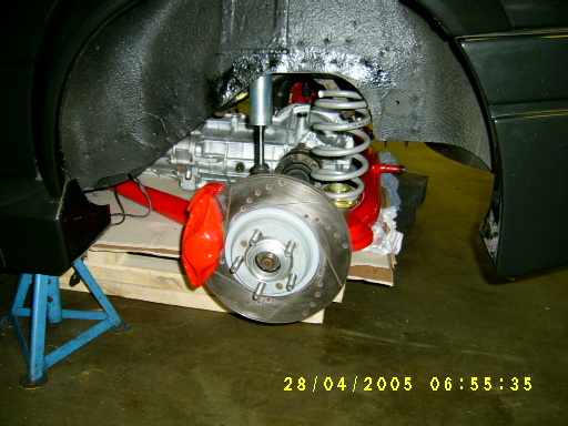

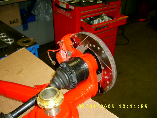

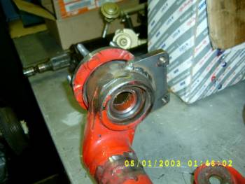

75 V6 Front brakes at the dedion, hydraulic handbrake, wilwood adjuster, gta 305mm 4pot brembo front, 25.4mm BMW master,

Very nice Lenz
Looking at the welding on the dedion, have you cut and shut for neg camber??

Thanks Andrew, extra camber and a little toe in.

I can see you have the RS Racing shock mounted upside-down to save unsprung weight. I understand the benefit from that, but for a street car I wonder if it makes sense as there is a significant risk of pitting the shaft and hereby ruining the shock. Any thoughts? I also have it mounted upside-down on my street verde, but am considering re-mounting it the other way to eliminate that risk.
