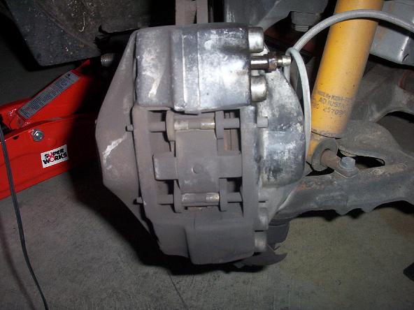

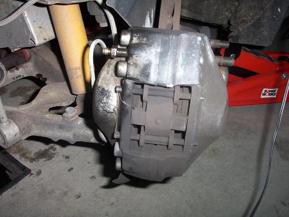

Barry,
Is my brake caliper on wrong side?
RH side of caliper
RH side of caliper
2005-10-22 050.jpg (43.51 KiB) Viewed 13948 times
LH side of caliper
LH side of caliper
2005-10-22 052.jpg (50.04 KiB) Viewed 13947 times
No,they all look good...Bleed nipple is up top...
I would suggest pulling them off and reconditioning them,from the looks of them,new kits and a clean can go a long way..
Bleed nipples look good all right.
For gods sake, put in some brake pads!! They look totally worn out. A sure way to f.ck up the brakes.
