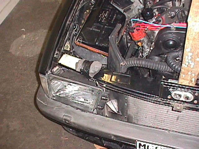

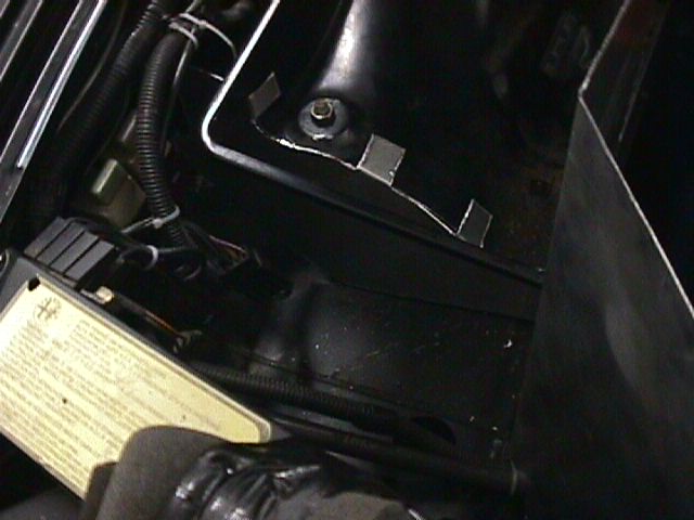

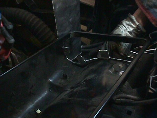

Some new uppdates. We´re gonna have our first track day for the seasom next weekend, so we´re hauling ass to be done by then.
Yesterday we modifyed the original air intake to get more and colder air. We cut the front of the filter box away to alow more air and also opened the front of the car a bit more to allow it to reach the box. Screens to block it off from the hot engine air was built aswell.
Some of the pics are crap, but I hope you can see something.

It´s a good option, i´m looking for something like that for my gtv6, i have a cone filter whith the megasquirt and i have 15-20ºC difference than exterior air, up to 40º difference at idle whith the car stopped!!

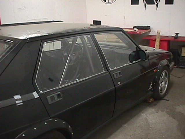

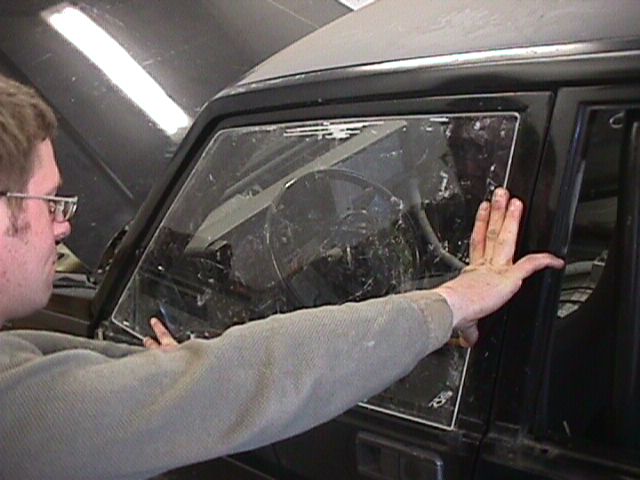

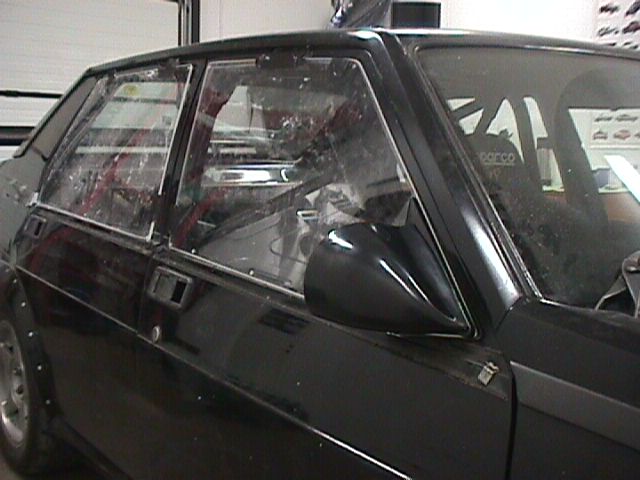

Worked on putting the plexi side windows in during the weekend. A lot of work, but it turned out fine. Also we finished the air intake. Seems to work fine and get A LOT of nice cool air! :D

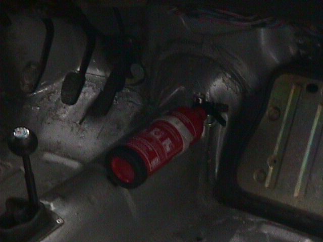

We also fitted the race mirros and the fire extinguisher.
I´ll let the pics speak for them self, my fingers are still tired from cutting and fitting the plexi... :wink:

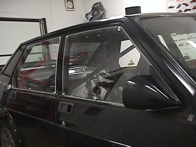

Finished mounting the plexi last night. I cleaned it of and took some new pics. They seem to be very big since the mouldings are missing around the edges. Looks kind of like the Popes parade car :D
Well it´s race, so who cares right!? :wink: The plexi works nice with the smaller side mirror aswell.

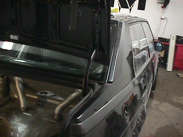

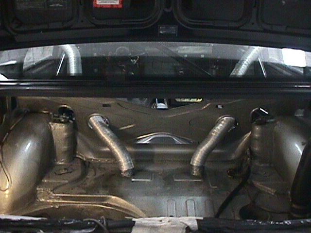

Some updates then... At the monent I´m building air cooling to the rear calipers. There is big cooling problem with them, all cramped up under the car next to the exhaust. I´m taking air in through the rear side windows and lead it by hoses through the floor of the trunk, straight down on top of the calipers and pads. Fresh for the season is also new brakes all ´round and PF 97 brake pads.

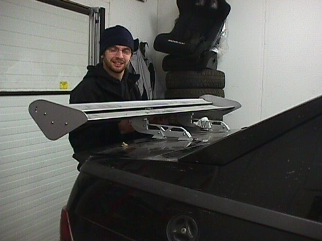

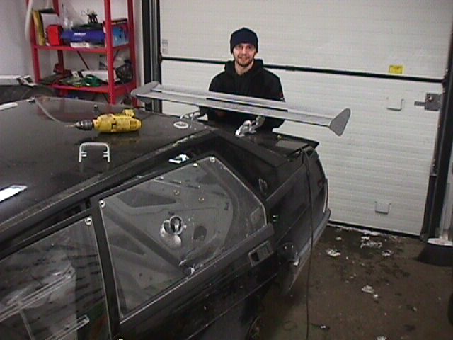

Also we´re looking for a new rear wing, something that works. In the pics below is one we´re thinking about.
Some pics...
