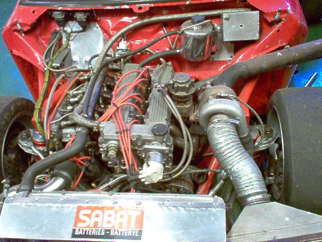

Hi Jim/mats
Right, the project is fully underway now.
Steel forged rod at +1mm are ordered, forged pistons also.
*****I need advice on the static CR*******
*****I need advice on cams..lift/duration*****
The road 75 turbo was 7.5:1 and the 75 evoluzione was 7.0:1. Was this just the difference in the slightly smaller piston on the evo?? or a homologation thing?
With modern engine management what CR would you suggest, keep it low - 7.0:1 or go higher 7.8:1??
Also the head work!!!!!!!! what about valve sizes. Say 46mm inlet 41 exhaust (standard alfa 2.0 ex size) or maybe 38mm ??
What about ex valve material, stainless steel/nimonic filled??
Remember this is a FULL HOUSE race motor....... Dry sumped, Garrett GT30-71r turbo, Girdled/strenthened block, solid prop, and full race suspension kit, just to give some of the South African V6 boys a fright!!
My Alfetta saloon racer is in a container on its way to live out there with Dawie (glenwood) so I can compete at the local races when I'm over there.
Seem to be there at least 5 times a year with work, so it makes sense to leave a car out there and have some fun. My last trip was with Roberto Giordanelli, and we tested, raced, photographed over 10 cars in 12 days!
So come on guys...... I need your help on this one!
Andrew b

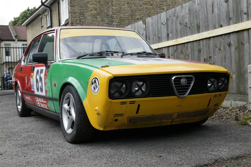

The car before the suspension mods and engine.......
Andrew b
Hmm, you're not consulting an engine builder? It's really difficult to just set numbers like that. I certainly don't have that kind of experience.
The turbo choise indicates that you might be able to run pretty wild cams and lowish static comp (7.5-8). Big turbine will keep the back-pressure nice and low. You need a good manifold though but that's obvious I think as is a full engine management system go for DTA (local support is paramount) or something similar, don't be cheap and try to save a buck... :wink:
Basically build a hot N/A engine and add a turbo. :twisted:
Andrew,your familiar with the ts turbo we did making 400 WHEEL hp...
Stock rods,but prepped,production Mhale Opel/Vauxhall pistons,MONOSLEEVE!!!(important-I have burst many a sleeve..)Nothing fancy..

It is sort of off topic, but I have to chime in that that (Sport Sedan?) is stunning!
I have a strong lust for that shape but I have not heard of many being built for performance. It looks brutal without the bumpers.
great stuff Andrew, please dont hold back from posting more photos if you have a chance.

zambon wrote:It is sort of off topic, but I have to chime in that that (Sport Sedan?) is stunning!
Hi Zambon
Thanks......... I'll have more pics shortly.
Going with 9x16 3 piece wheels and slicks, so the arches will need rolling out a bit. should look mean after that!
I have a lead on a straight cut 'dog' box....... 4.3 final with 5th 1:1 . I hope it comes my way soon.
Cheers
Andrew b
