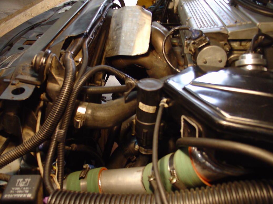

I see what you mean Mats. You are correct. Using the AC to cool the charge as it comes in just wouldn't work. It would take a HUGE AC compressor and it would rob too much power when you turn it.
The method we are talking about simply cold soaks the intercooler during off boost driving so that's it's way below ambient temperature (like 40 or 50 degrees below) when the boost turns on.

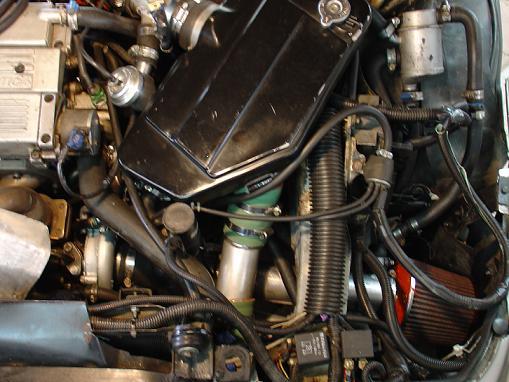

I used both intercooler and Chargecooler on a 2.0 turbo Fiat\Lancia engine few years ago, I used 2 electric (renault Clio william's) heating recirculation pumps in row and a bmw 528 air con radiator with 2 Spal 9" push fans , it worked brilliantly....
That was a Subaru 2.5T legacy chargecoler that I chaged its air entrance direction.

I like the Zuke bomb Barry, what are some general pump flow rules of thumb with an chargecooler like that size? 500+ GPH ????(bilge pump etc) the more the better???
