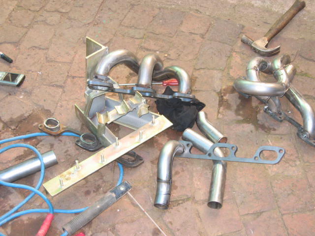

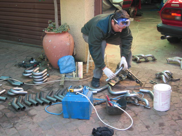

Started a few weeks ago making a few sets of headers. I found it impossible to get equal lenght headers on 41 ID and 43ID pipes on the 24v IF you do not cut the body or shift the motor(loosen engine mounts).
I have a good set at the moment which I will take to the specialist who can weld it up properly. I just cut and tack it(burn holes) together to test the fit in the engine bay.
When they come back I will post the pics.
Anyway here are two pics at the moment.
Sorry that was the wrong pic previously.
Using the templates as shown you can make it perfectly every time.

wow !
great job kev ! :)
PanchoRama
Kev,You said the semi equel headers would not fit..they look good to me..whats up,why wont they fit??
ha,now I see why the welding is so crap on your samples you showed me... :wink: :wink: :D :D

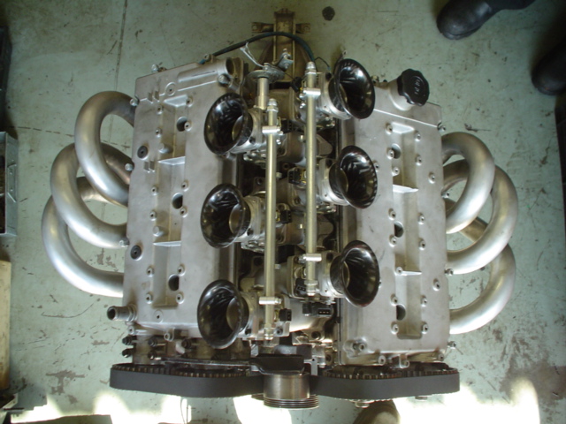

Andrew.b
Posts: 205
Post by Andrew.b »
Mmm. Looks familiar barry.
the second/spare engine from a well known red Alfa 75 racecar here in the UK wink:
Andrew b
Yeah, Barry they do fit BUT the other side is a bit testing at the moment around thye starter motor.
Barry, are those TBs the AH motorsports setup?

Glenwood are a world renowned Alfa Tuning house, but are not a factory suported manufacturer like AMG or M.
If you want 400 odd HP from an Alfa, there are three routes:
All require aftermarket injection.
V6- 4vhead or 2v head. The 3.2 GTA engine can be taken out to 3.8L, and with big compression, porting, balancing and a multithrottle inlet, the South Africans talk 400hp. You are revving this thing pretty hard at that point, you have to if you want more than 100hp/litre naturllly aspirated. I dont believe claims of 500hp unless the rev limit is around the 9500 point.
2v head 3.0 can be taken out to 3.5. Good rods, big comp, porting and cams, and lots of revving, and you get the idea. 100hp/litre common. my 2.5 revs hard for 250hp.
Turbo V6 setups. sky is the limit, but the successful twin turbo V6s out there use front mounted gearboxes to cop the crazy torque.
Turbo 4 cylinder. Lighter than the rest, build a good engine, prob cot you less than a worked V6, and go harder IMO!
